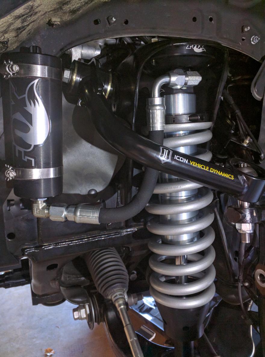

I have the 6112/5160 on my 5th gen. And my friend has the boss lift on his FJ and I swear my 4Runner feels better on the road

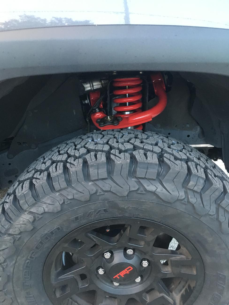

Waiting on the boss Coilovers to come off backorder.
I have had Skyjacker, Fox, and Icon on my Tacoma but my 4Runner will not see the abuse the truck did. On the Runner I wanted simple, mid-quality, vehicle specific valving, and adjustability. Thats just what I believe the BOSS 2.0 coil overs offer so I went that route versus the bilstein 6112.
I'm hoping for a factory like ride quality but slightly more stiff. I'll post again when I get some miles on the setup.

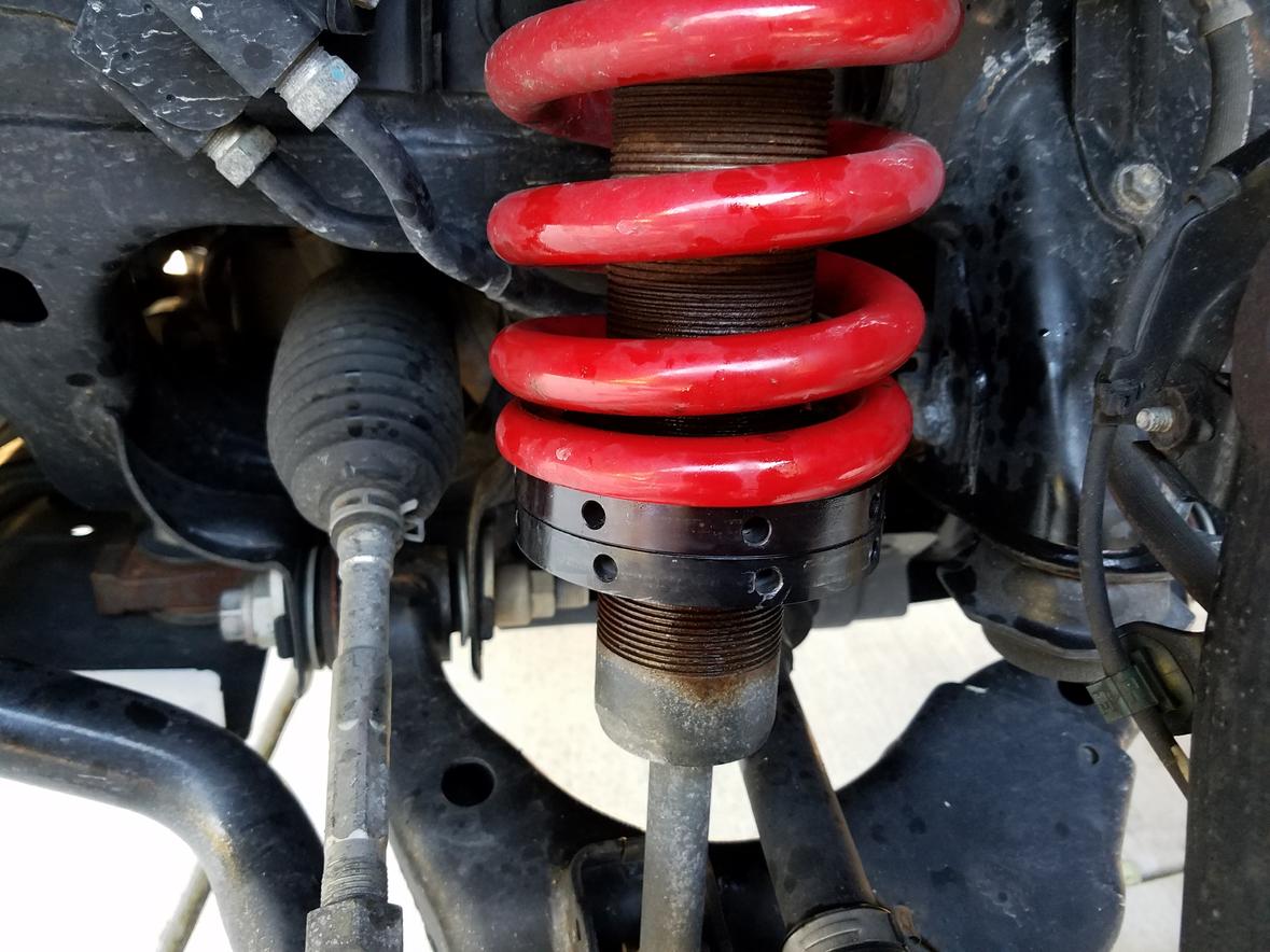

Dont go toytec. I installed a full boss setup with Camburg uniballs and the toytec fronts were ok for the first year then they started clunking(like the sound my old trucks front struts made when they were bottoming out), but what really gets me is that I tried to readjust them because they've started to sag a bit and they are completely stuck in place because the threads have begun to corrode. I battled them for a couple hours last weekend with no luck. So, technically these coilovers are adjustable, but only at install!! It sucks.
I thought they redesigned the front coilover a year or two ago, getting away from the two collar system for adjustments because of the possibility of them seizing (I can remember at least one or two others having it happen).. Yours look quite corroded, I've got over three years on mine and they don't look anything like that, but I have no need/desire to adjust them.
