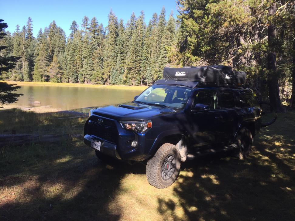

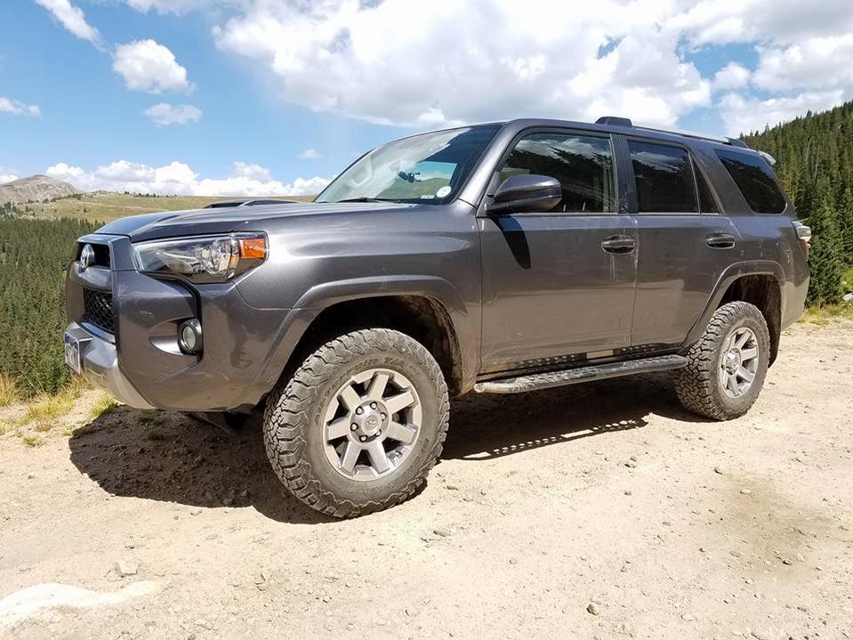

View attachment 265872View attachment 265873
275's???

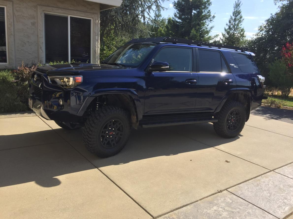

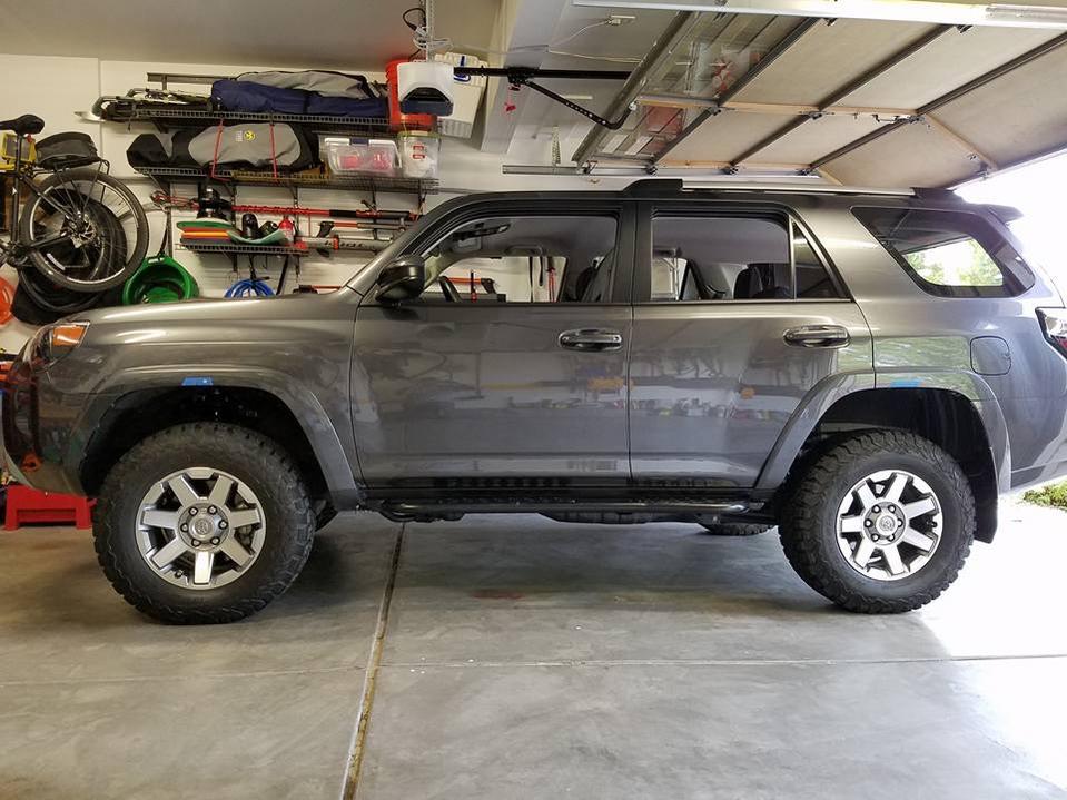

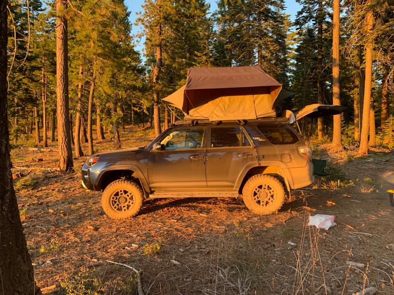

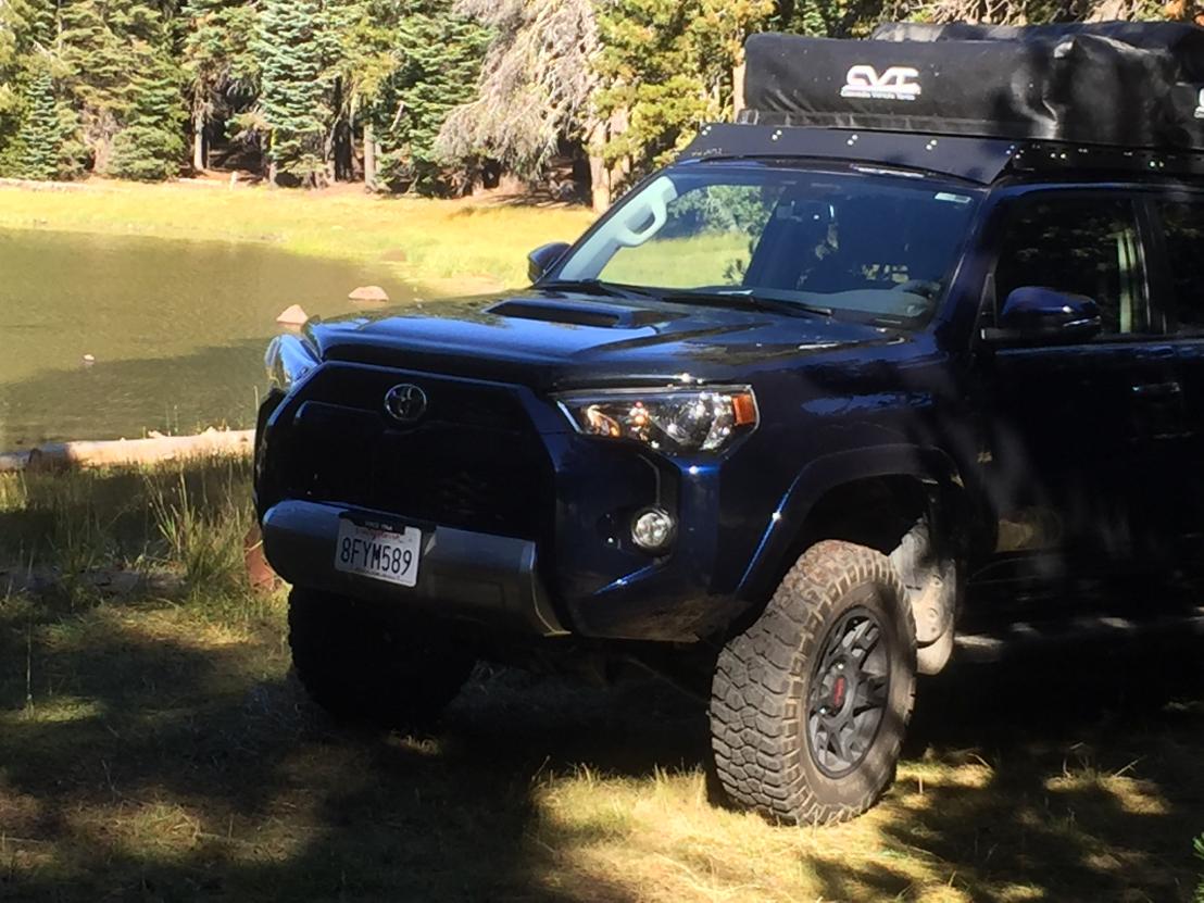

I would agree with safdSA. I really like my 6112/5160 combo for what I do (mostly fireroads to remote camping spots with a RTT). The 6112/5160 Icon 2" rear spring has been on for about 9 months and about 1k off-road miles with no issues. Now the pin stripes from brush that's another issue.....
