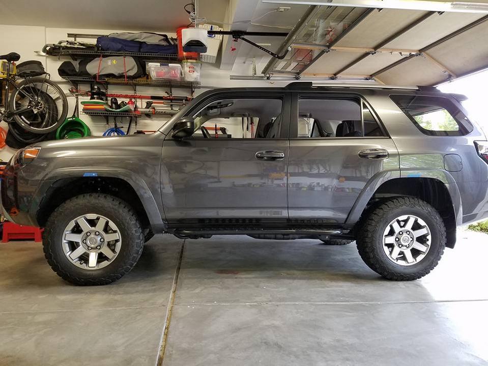

I installed my Toytech Boss 2.5 coilovers 8 months ago knowing I would eventually add a winch bumper with a winch and an aftermarket skid plate. Well I recently did just that. All that extra 350 Lbs or so pulled the front end down about an inch. Today I grabbed the spanner wrench and a 3' cheater bar, sprayed some WD-40 and went to work. They still look like new. No rust or corrosion.
The first 1/2" went pretty easy. The second 1/2" I had to use a cheater bar as it was getting pretty tight. It took about 45 minutes to crank it up an inch.
Would a heavier coil be a better option (truck suspension newb)? Not sure if TT Boss has a heavier coilover option or not.
Side note, love how your rig looks. like the writeups on your site as well. Got any pics from that big bear black diamond run?
They are the heavier 650Lb coils. I bought them knowing I would be adding the extra weight.

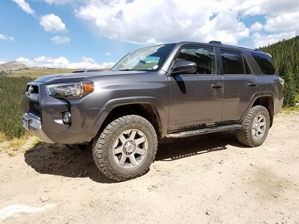

A couple of Big Bear Runs.

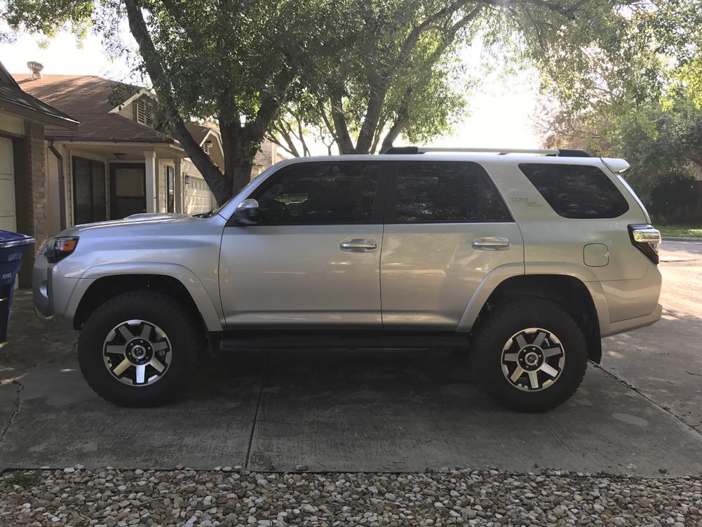

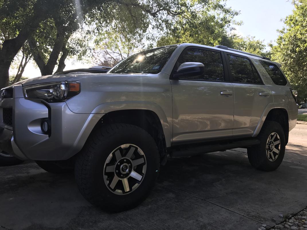

Hello all. This is my first post here although I used this thread to make my decision about the suspension I wanted to use. I recently purchased a 2017 TRD Off Road. Much like everyone else, I could not stand the front end break dive and I also wanted to lift the vehicle a bit. I spoke to a few guys at 4 wheel parts about which path I should go (even though I know what I wanted) Playing dumb, they were very helpful in pointing why the Bilstein setup would be perfect for my mostly highway commute but occasional off road camping trips. The rear springs is where I didn't know what I wanted. I plan on getting a small camper down the road but for now, we load up that cargo area with all kinds of camping stuff. They recommended the OME 3" medium duty springs. Now with this installed I still maintained the factory rake (which I'm not too big on.) I think there are smaller rear springs one could purchase to get a more level ride. Empty ride is slightly harsh if you hit let's say a railroad crossing at a high rate of speed but overall the ride is extremely smooth and glides over potholes. Should be noted I do have 285/70 tires on stock wheels so I think those soak up the bumps as well. For me, this is an excellent setup and much much better than stock ride. Ride quality over looks is what I went with and got.
