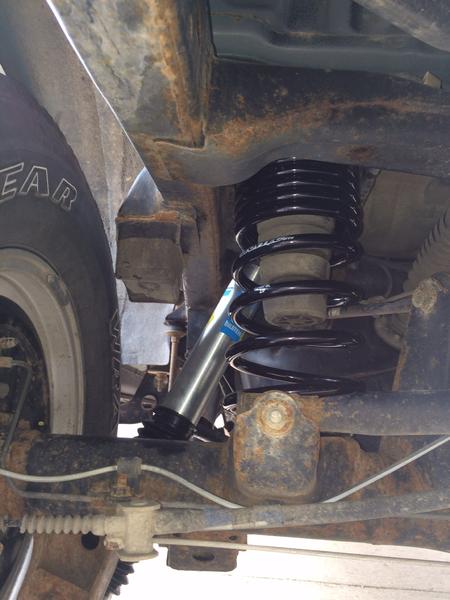

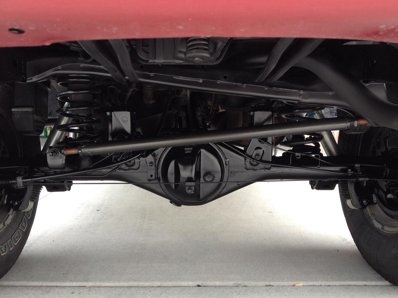

This is the superflex with extended bilsteins in my driveway. Do you need a closer shot?
6B783735-ED32-495A-9BC0-7CE8B1782D5A_zpsveyaemef.jpg~original
I would have to see what you are talking about. The coils must be installed wrong for that to happen. With the cones installed in my springs I still have a ton of room before they would ever make contact with the rear axle. Heck they probably couldn't anyways.
This set up should be good. Many people run bilstein 5100 with superflex even toytec recommends those shocks with those coils. I'm installing mine this Friday. Show us some pics. !!!!
I'm running the same setup and have been for the last 6mths and have had zero issues. Show a close up shot of just one side so we can see how its installed.
Wow. That undercarriage looks like it just rolled off the show room floor.
