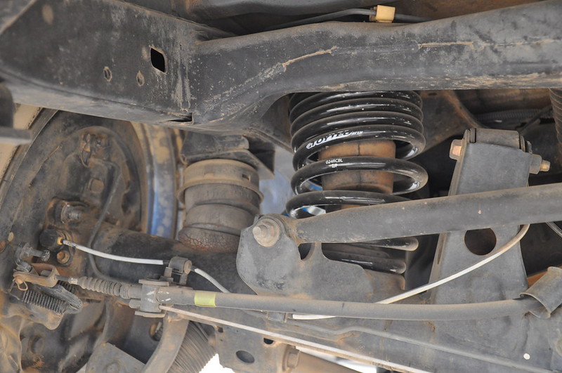

Here ya go, i had this photo earlier but for some reason i cant post photos thru Tapatalk anymore. I didnt realize how bad it was til i took this photo but the top SIX coil winds are compressed together! :redbrick: on flat ground, in my work parking lot.

Thats actually how they are supposed to be and there isn't anything wrong with them. That way when you flex it out, the upper coils will expand and prevent the coil from unseating. The Superflex's are meant to be a linear rate coil.
890's, 891's, and 861's are the same way.
Thanks for the clarification Dylan, i thought they were designed to be progressive. Never seen a coil designed to collapse like that. I guess the only thing "wrong" with them is they cant handle the kind of weight most serious offroaders are going to throw at them.

No prob. We made them that way for the people running lc shocks or longer so they wouldn't unseat. On one of the 4Runners at the shop, the 890's came unseated at full flex with the shocks that are in it so we wanted to prevent that but not give it a crazy amount of lift.
