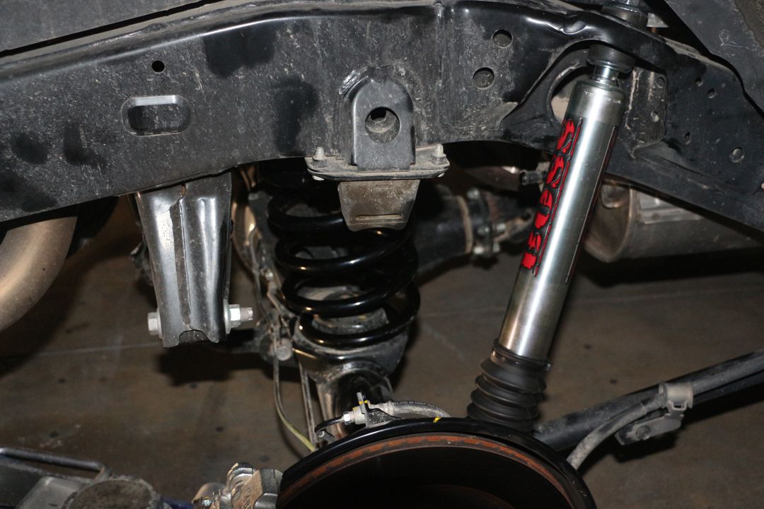

While I'm at it, let's talk about the rear bumpstop extensions. Who is running them? What are the pros and cons? I see the rear shocks say they are good for 1-3 inches of lift. So would the shocks bottom out before hitting the stock bumpstops? If that's how it works, why are the bumpstop extenders 2 inches instead of 1?

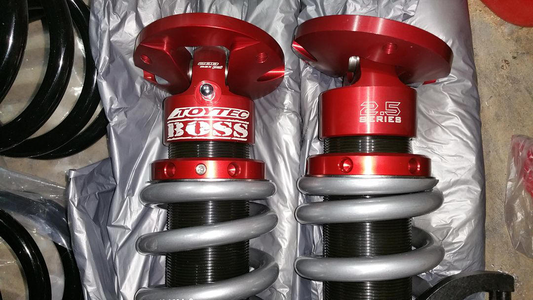

Is this (the bolded part) true? If so, is anyone finding themselves needing to lube the lower mount due to squeaks or otherwise? It's my understanding that bushings are superior from a longevity standpoint, like the Bilsteins or even the boss rear shocks.
I think he meant they use Heim joints not uniball. both upper and lower joints on the 2.5 Boss are Heim joints.
I went with the 2.5 for the extra strength on this heavy pig. At the time I was going to order there were a bunch of others bending their shafts with the standard lifts with all brands so I wanted the extra piece of mind when off roading.
I just picked up the same 2.5 fronts. What did you go with in the rears? Did you install them yet?

In the rear I went with Toytech 1-3" lift shocks and 2" Toytech superflex coils.
Yes I installed it a couple months ago.

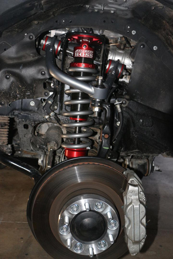

Im about to purchase my 2017 TRD Off Road (AKA trail edition) in the next month and I'm looking into the Boss Suspension. I am new to off roading and want to ease into it seeing as its a brand new vehicle which will also be my Daily Driver.
My intention is to put 285/70/17 with this lift, but my question is what is the necessity for someone like me to replace the Upper Control Arms? Would I be able to still have a great ride quality and performance with the stock UCA?
I see a lot of back and forth in regards to rubbing and strange noises, so I would like to learn more about the benifits or necessity of having a new one vs keeping the stock UCA.

I love the boss lift, have had it on my truck for a few years and have no complaints. You can either buy UCAs now or later, but they really make a difference in alignment and it does provide for more travel up front then the stock. The downside is a little more maintenance with them, uniballs may require even more maintenance. For example, I have found I need to grease the bushings on my Camburg Bushings about every 8-10k to keep them quiet. The cheaper UCA's option are the SPC light racing, it'll give all the caster you need for the lowest cost, but at times they've had some qiuality issues. There are plenty of options but none are cheap, my front is lifted about 2.5" and I was so happy when I replaced my UCA's, drove a lot better.
Look around for links on the different UCA's options, there are several lengthy threads, new are a couple...

Ok great, that actually helps a lot. I wasn't too sure on what extra maintenance or additional costs I would need to consider. The dealer who I plan to purchase my lift through had suggested Total Chaos UCA if I chose to go that route. I am in the process of researching the different options as we speak.

You say you want to ease into off-roading so leave it stock and ease into it. Don't make changes for the sake of making changes. Unless of course you like how it looks and have the money to burn. If anything, upgrade your tires and go have some fun. Many people on this forum have been to some pretty incredible places with a stock height 4Runner. Just sayin.
