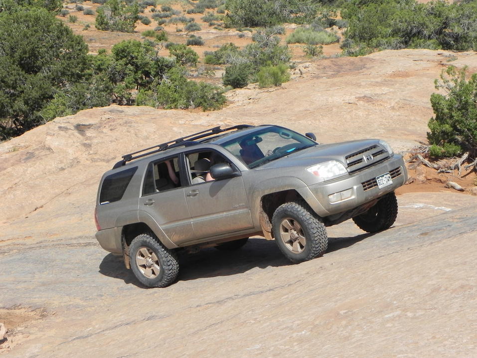

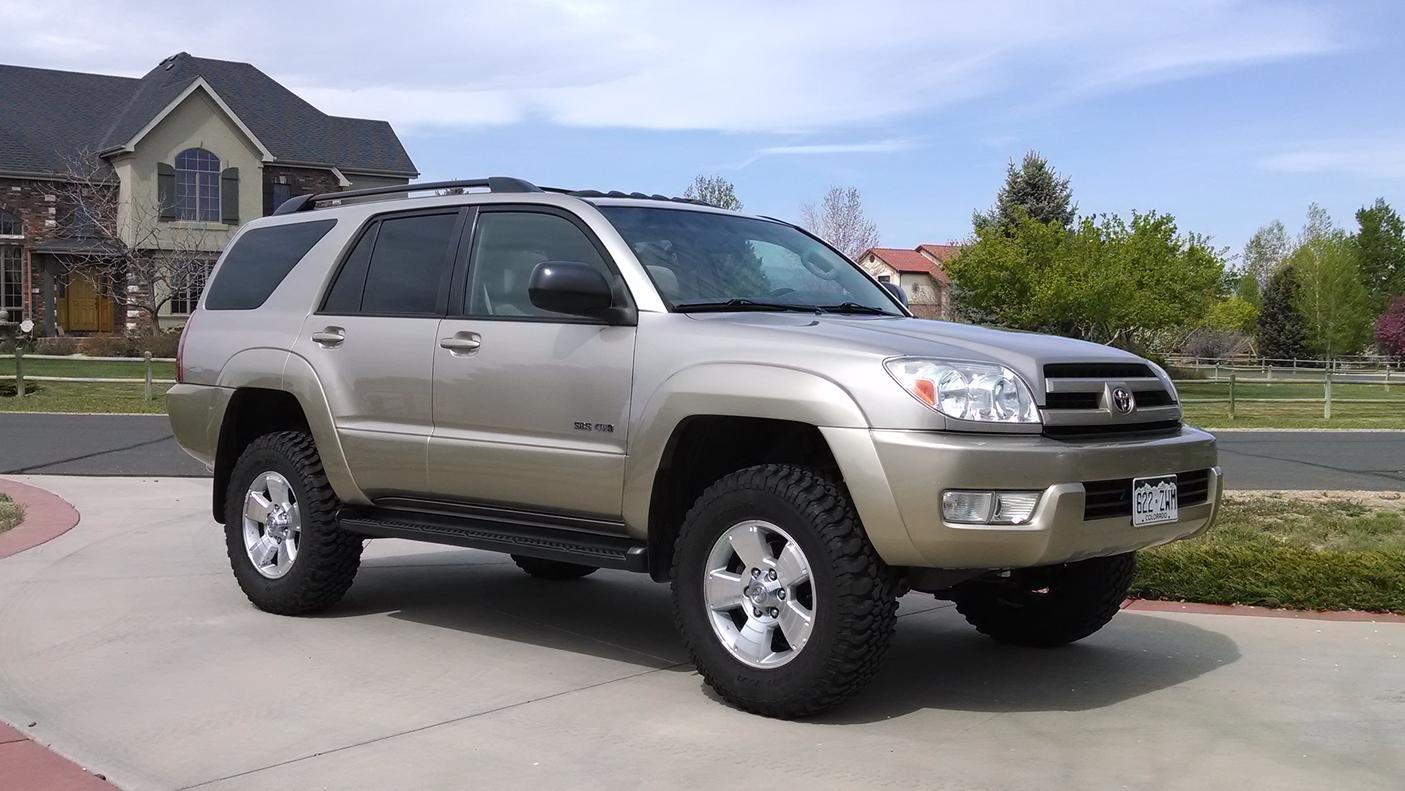

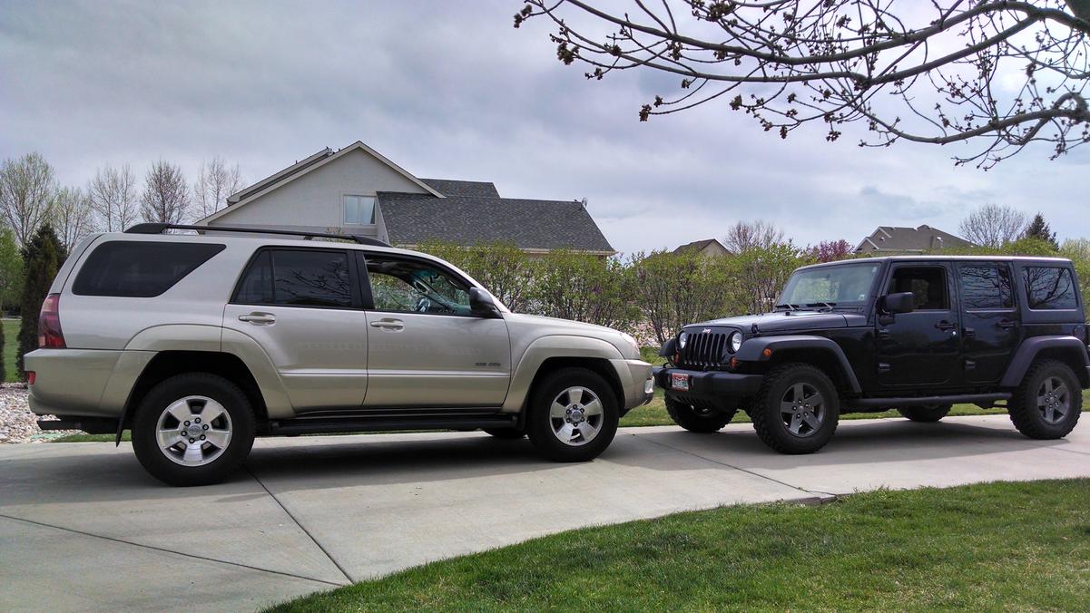

Attached are some before and after pics. The Jeep in the pic is a Rubicon that my buddy and I lifted at the same time. The after pics show the 3"front/2" rear Toytec Boss lift installed and stock Rubicon tires (255/75/17 MT). The trail pics are from Moab, the first trip with the new lift. I took off the running boards but haven't had time to get sliders installed yet.
I went with the Rubicon tires because there were quite a few on Craigslist (just a touch over 32"). This size fits in the spare area under the bumper.
I didn't take any pics during the install but if there is something you would like to see I would be happy to take a pic. We used PB Blaster but I did have trouble with one skid plate bolt and had to cut it off (not bad for a 11 year old car). In the rear, besides needing a spring compressor to make it easier (you can borrow them from the auto parts store for free), the other tight spot was the top nut for the rear shocks - you don't get much room to swing a wrench and it is tucked up behind the body seam. Toytec said some people just trim that extra metal to make it easier to get at the nut - we had a rathcheting box end wrench that made it a little faster.
