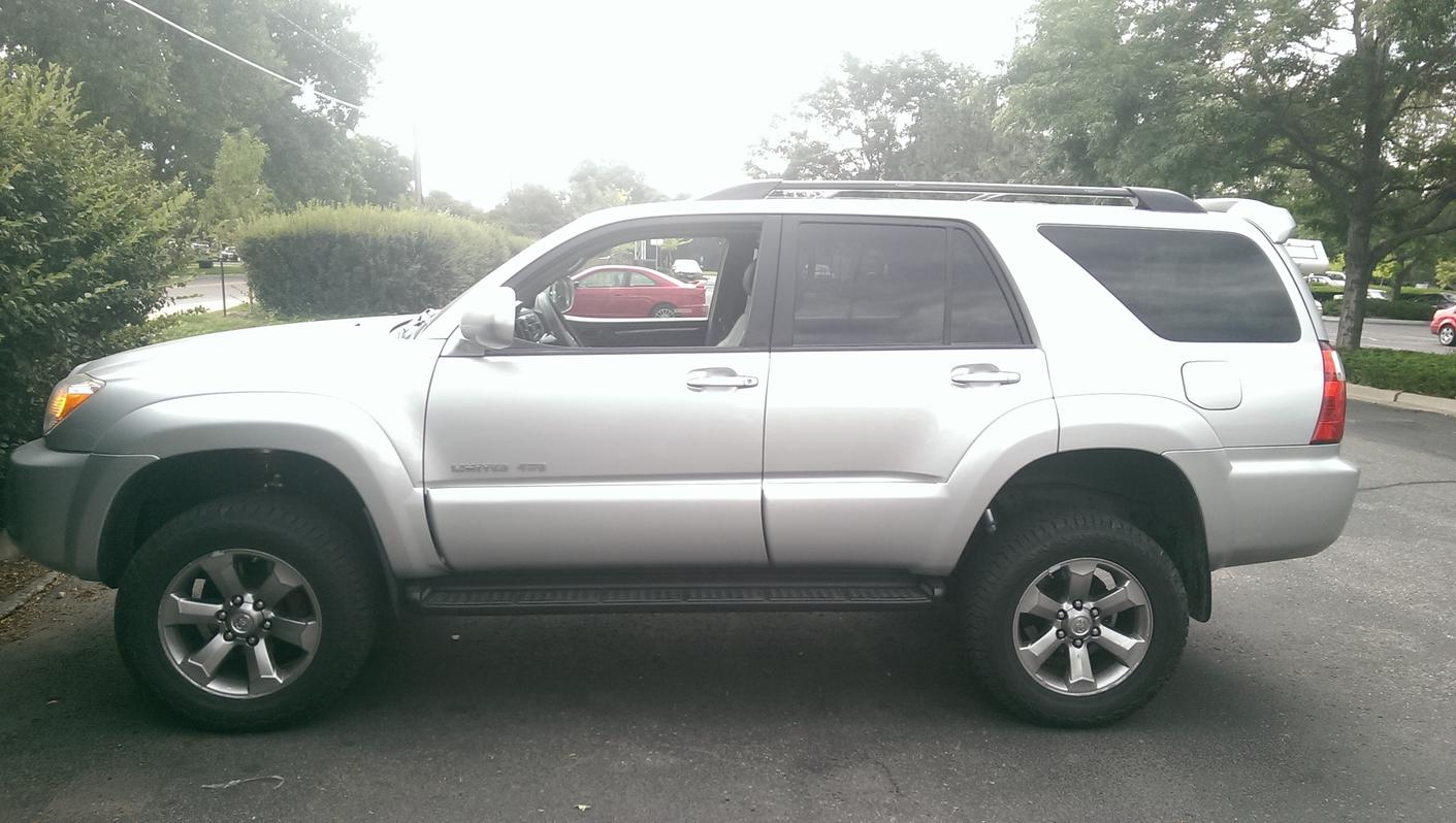

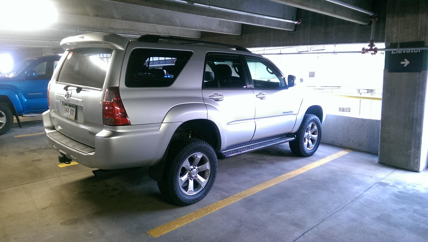

Attached are some before and after pics. The Jeep in the pic is a Rubicon that my buddy and I lifted at the same time. The after pics show the 3"front/2" rear Toytec Boss lift installed and stock Rubicon tires (255/75/17 MT). The trail pics are from Moab, the first trip with the new lift. I took off the running boards but haven't had time to get sliders installed yet.
I went with the Rubicon tires because there were quite a few on Craigslist (just a touch over 32"). This size fits in the spare area under the bumper.

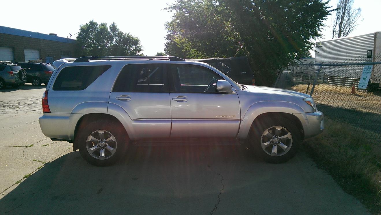

All that has gone on so far is the 3" Toytec ultimate, Spidertrax and Sway bar bushings. Minus the rear, which as feared was the wrong size. It takes a 21mm per their measurements.
Here is a before and a couple after pics. Don't mind the uneven and washed out lighting, and trust me, I enjoy photography, so I have to fight to look past it! However, you will get the idea. Enjoy! Next come the new tires. They should be on tomorrow.

Looks awesome, bud! Yeah, like yours, my rear sway bar is 21mm, so I had to put my rear bushings on hold as well. Now you just have to lose the pookey little tires and get some 285's on there. Oh, and I saw that your "vibration" issue was a rusted, loose heat shield. Glad it was something minor so it didn't spoil the fun of the new lift!
