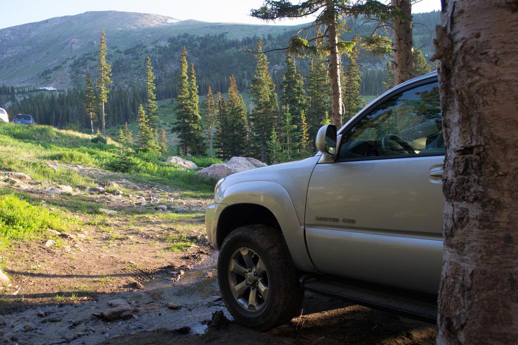

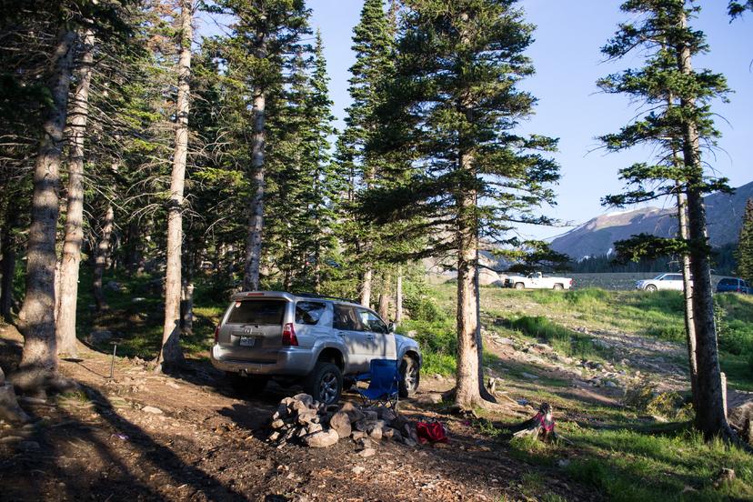

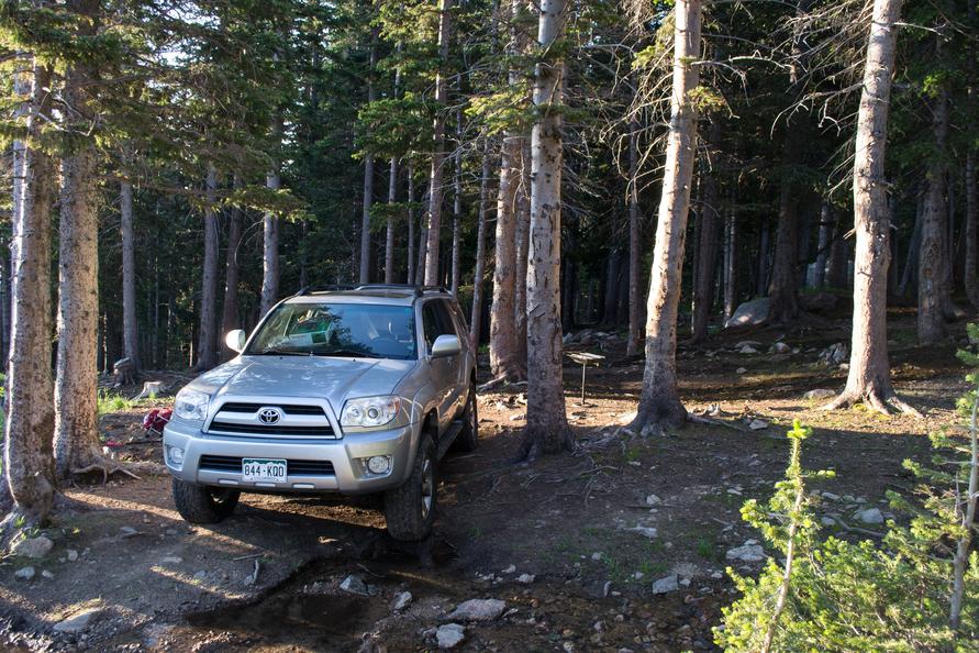

I didn't get in to grab the report from them yet. However, I did call them up and inquired.They said the same as you, not necessarily. I went camping this weekend and took it on its first real 4wd adventure and it performed amazingly. Here are a couple pics :)

Damn, I love Colorado (and no, not for the weed). Was in Winter Park last December with Mrs. Preacher and the children and will be there again this Christmas. Don't get me wrong, I love Texas and the beaches, but I sure miss snow covered piney mountains!
Haha, if it is for the weed too, that is OK by me. Colorado is amazing. My wife is from Texas and I really like it there to, but Colorado has it's own charm that can't be compared. I am sure it is the same with Texas is some ways.
Hey who knows, maybe we can meet up at some point when you are down this way.
