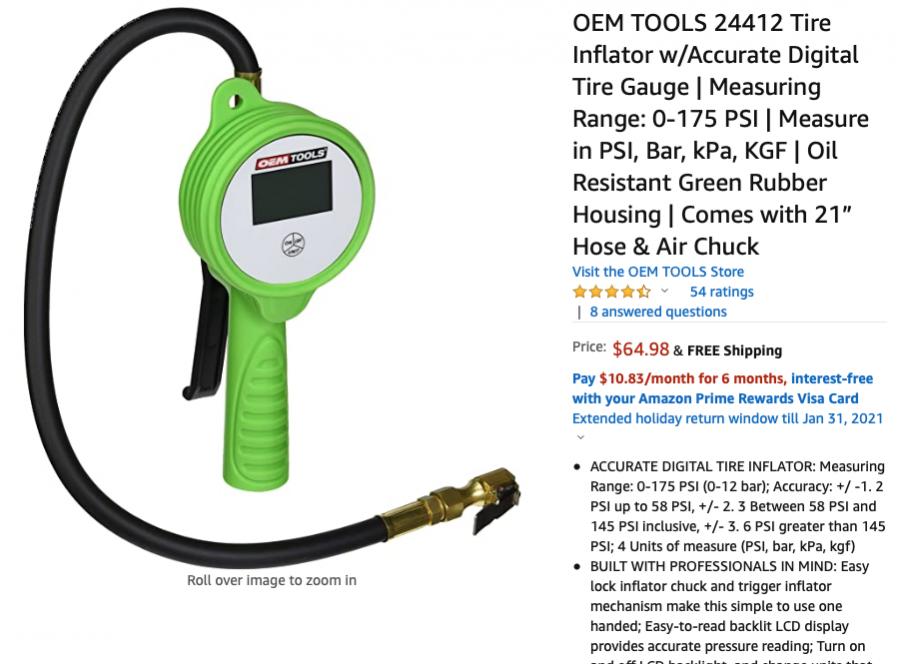

I use this and it always matches the TPMS
