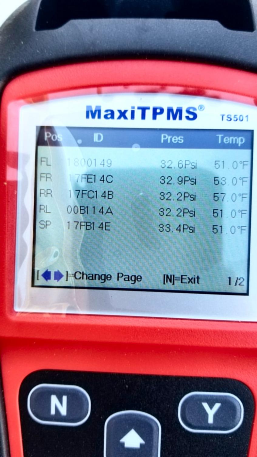

In turn I used the ATEQ Quickset Tool to both get my current sensor IDs and program the new IDs.

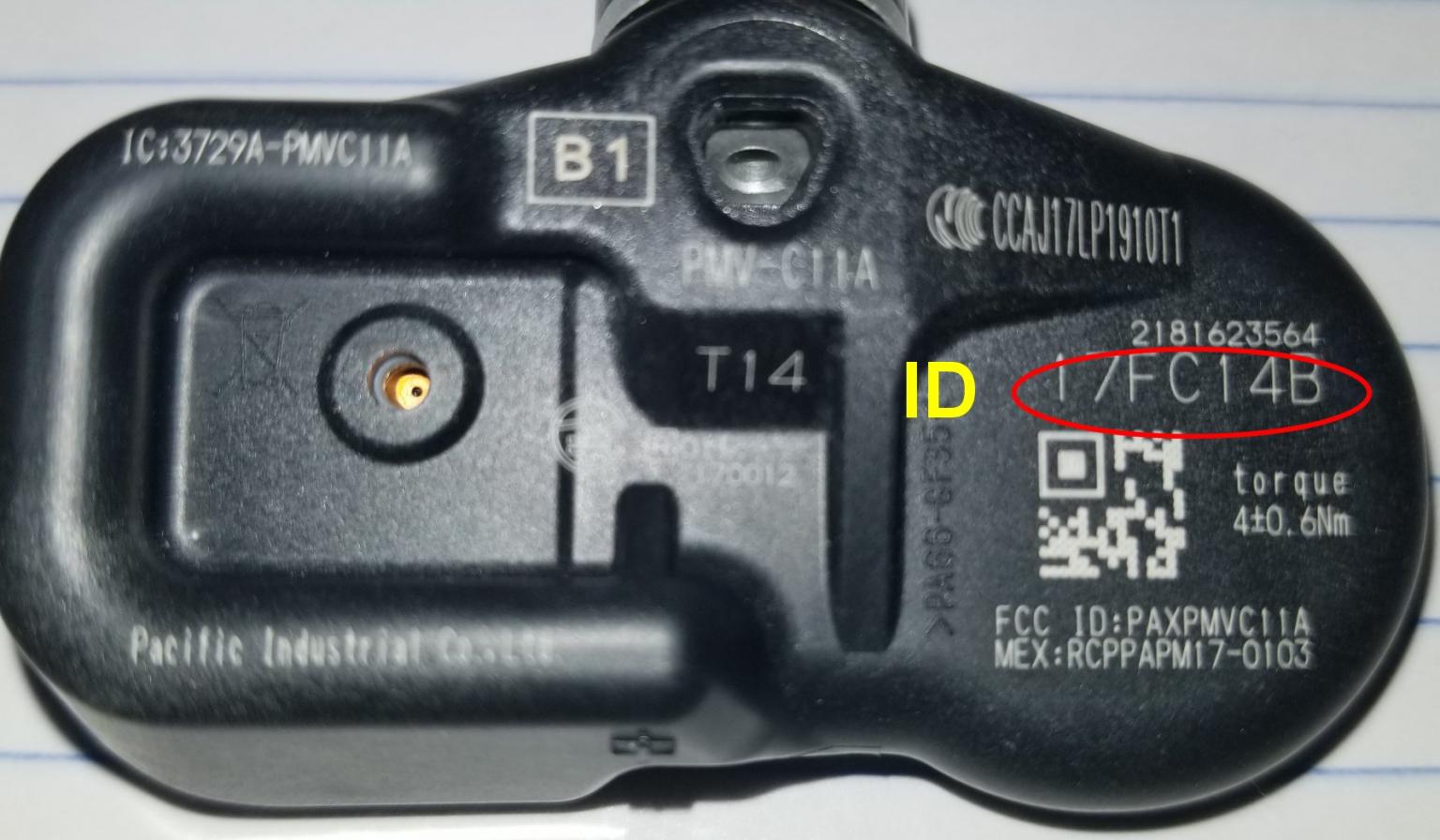

When you buy new tires the sensors do not have to be reprogrammed. The ECU already has the ID for each sensor. When you have new sensors installed then those have to be written to the ECU. (I think I've heard newer T4R ECUs can read the IDs, can even have 2 sets so you can have snow tires with the sensors.

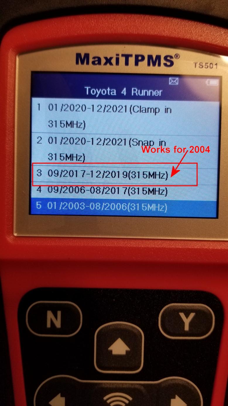

I have a 2004 T4R bought in 2003, beginning of the model year. I just replaced all 5 of my sensors with Denso sensors from Amazon. I had 1 bad sensor, making the indicator flash. I had 1 sensor still reading good, 3 others were 'low' but working. I checked with about 3 tire stores and got the same story. They didn't have the Toyota Techstream software (very expensive) to program the Denso sensors. They WOULD install their own brand.

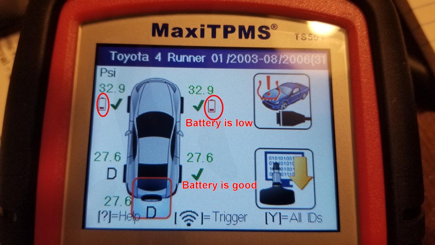

The next time it's flashing, to determine which one is the problem without any tool other than a tire gauge and access to a compressor, lower the tire pressure in one tire to below 20 psi. Turn the key on and see if the indicator is steady. If so, air up the tire and move to the next one. Continue to do this to each tire (spare too) and eventually the indicator will continue to blink. That's the tire with the bad sensor.

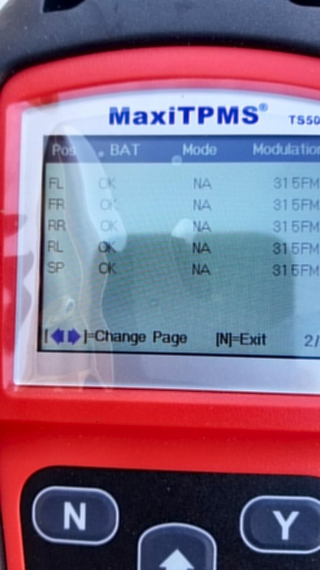

I purchased a tool that will read the sensor(s) and then write all of them to the ECU. That was $200, but cheaper than the dealership. I had a little trouble getting it to work for my 2004 model but the support team for the tool was VERY helpful and I just had to select a newer model year and the tool worked perfectly. I had the tire store replace all of the other sensors, I read them all and wrote back to the ECU. No flashing, all sensors read 'good'.
My total cost for tool, TPMS installation and Denso TPMS purchase from Amazon was $500. If you want to go a cheaper route, just have them install whatever they can program.

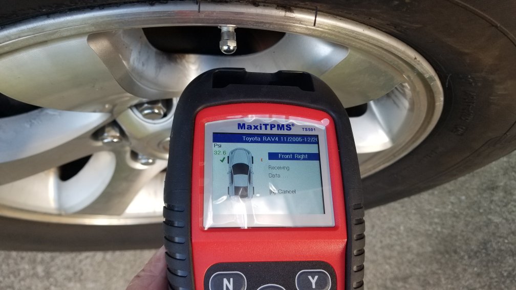

The Autel tool I use is real easy. You go to each tire, press a button to get a reading, go to the next tire. After all 5 are read you press the top right button on the screen and use the 'learn' step to write to the ECU. It took all of 7 minutes when I used the right vehicle setting. My son has a 2006 T4R and he has to replace his, so next trip up there I'll take my Autel.

The ECU learns only when you upload new sensor IDs. Most likely your sensor is just getting jostled into working again. It may have some corrosion somewhere that's impacting it.

A couple of nice things about owning that tool. I can check tire pressure and tire temperature with it. I press a button and it takes a few seconds to get a readout. It also shows the batteries' condition so when it comes time to buy new tires I can have them put in new sensors before I have a problem, like last time.
