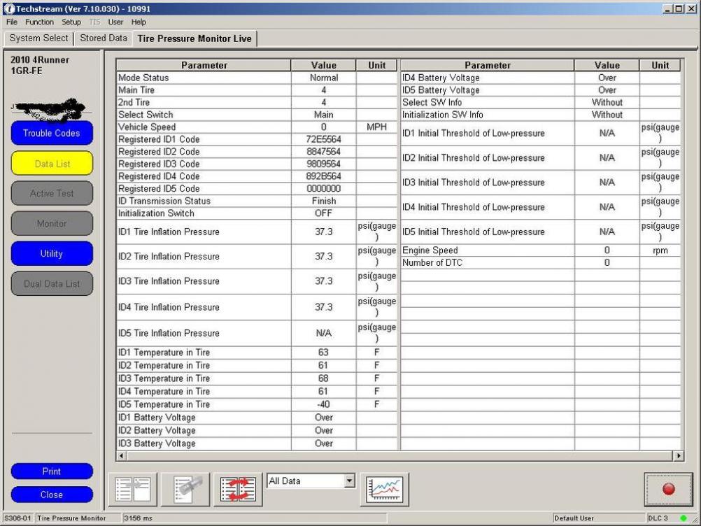

Here’s a Screenshot from TechStream. You would think it will take a fifth sensor but it does not.
Have you ever had a sensor installed in the spare? Looks like it would certainly be able to read it since there is a space for it. Using my reader I can read the sensors without them being installed in a tire. Does the Techstream have a reader or does it just read them after installation in the tire through the ODB II port?
