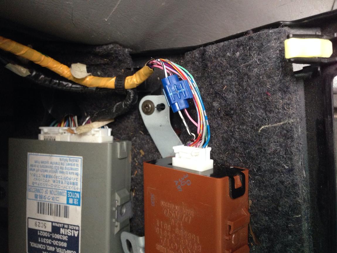

Yea I did the bypass. Bye bye light

I thought I saw some guys jumping the pink/black wire only to an additional ground source, but it looks like you jumped your pink/black wire to the white/black wire. Are these the same processes... or is the pink/black to white/black an easier source for ground?

pink/black to white/black is what I did and it has worked. no problems with it.
That's all I needed to read... it works and you're not having any problems. I'm heading out to the garage to take care of mine right now.
