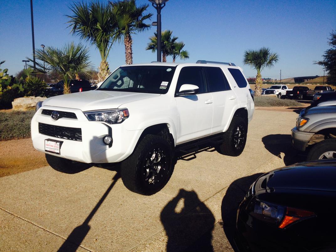

I do plan a minor wheel/tire upgrade in the near future, but I can afford a lift now to get ready for it. I was at the dealer getting the oil changed in my Tundra when I was sucked in by a SR5 4runner with 3" (Helix?) lift and tire/wheel dealer upgrade. I test drove it and was happy with the handling, but the $7,000 price tag for the upgrade put me off. I walked the lot and found a better base equipped Trail edition for $7,000 less on the sticker and no lift. Bye bye Tundra, hello Trail. So I want to work up to the lifted version at my own pace and price. It just seemed like everywhere I looked they had that "Not for the Trail" qualifier, and I wanted to know why. As a first time question in here I really do appreciate the replies. :biggrin2:
wow 7k for a lifted sr5 over msrp wtf????? no way for 7k you could lift, tires and armor and an air locker.

I can believe that they wanted $7K more for the lifted one. A Toyota dealer here in San Antonio had several lifted Tundras last time I went in for service. They wanted if I recall at least $10K more just for putting on the lift, tires, wheels and bumpers. You could easily buy the stock truck and do all those mods plus more for less money. Especially because these were just front spacer and rear lift block lifts.

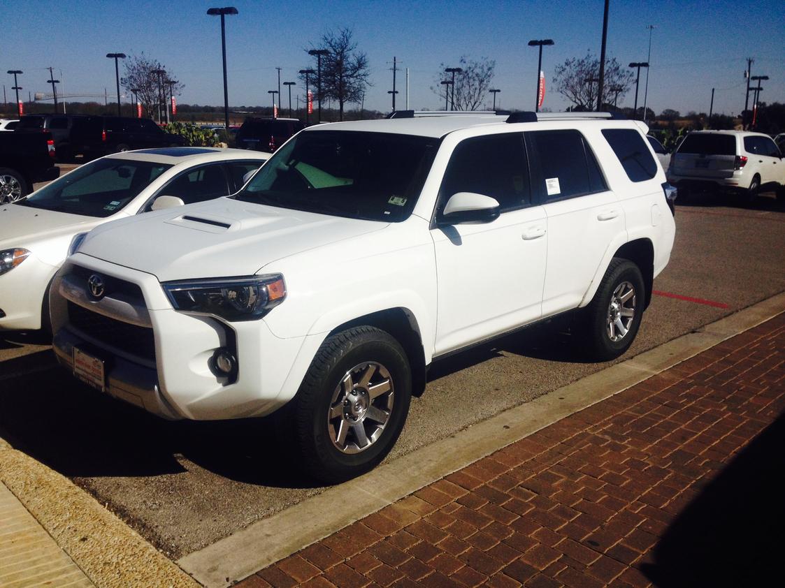

On top is the eye candy that sucked me in. On the bottom is what I bought. I got it at North Park Toyota in South San Antonio. I'm working on a rig about an hour south of there. We don't need front plates in Louisiana so I'm already going to get a new front lower valence. They drilled 3 nasty looking holes in this one to hang that plate holder on it. I do have a bug shield, vent visors, and a Nfab step bar already ordered. Small steps. ;):
I know the parts manager that works there. They get all their lifts, wheels and tires through 4wheelparts (which they charge big $$$ for installs). Couple of other local Toyota dealerships do the same.
These dang stealerships... SMH
^^^That's the dealership I was talking about previously! I really like their service department, but they (like all dealers) rip you off if you buy something with a lift, tires, wheels, etc. Good to see they have at least a couple of trail editions. Every time I go for service I look, but this being Texas and San Antonio in particular, they always have acres and acres of Tundras, some Tacomas and about 10 4Runners; all of which are SR5s and Limiteds and about half of which are 4x2 :-(

You got the better end of that deal.
When I bought my '12 TE the dealership had already installed an OME lift, XD wheels and 33" tires and LR UCAs. TEs are extremely difficult to locate here in Texas and I was planning to do these same mods anyway, so I didn't have an issue with the mods already being done, except for the price the dealership was adding to the overall price of the truck. I have a good friend who is the SW Region GM for 4Wheel Parts. Before sitting down at the negotiating table I called him and gave him the mod details to price out for me. He called me back 20 minutes later and quoted $3,500 out the door, while the dealer was wanting $8,000. Given that info I was able to get the dealer (reluctantly) down to $4,000, even though the 4Wheel Parts price for me was essentially an employee discount.
The good part is that all of the mods are covered by the same vehicle warranty. I've had one of the UCAs replaced beyond the 12 month manufacturer warranty. The dealer covered parts and labor.
