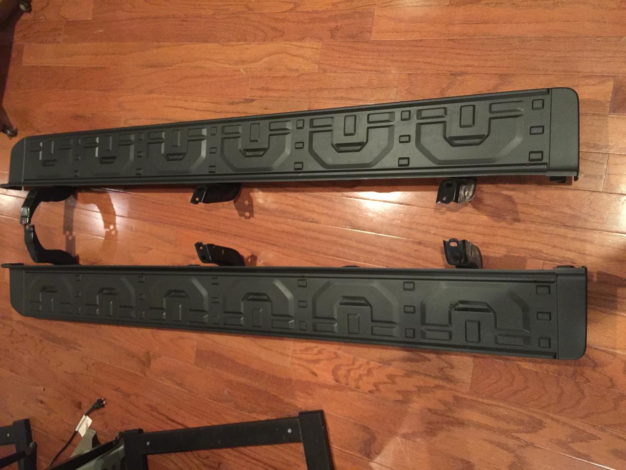

Yes please check....$250 plus shipping seems reasonable as long as they look new. Also pics would be great as well !
Just got back from UPS and brought them in... 70 bucks to package plus 160 to ship to Boston :Cry: Didn't expect it to be so high.

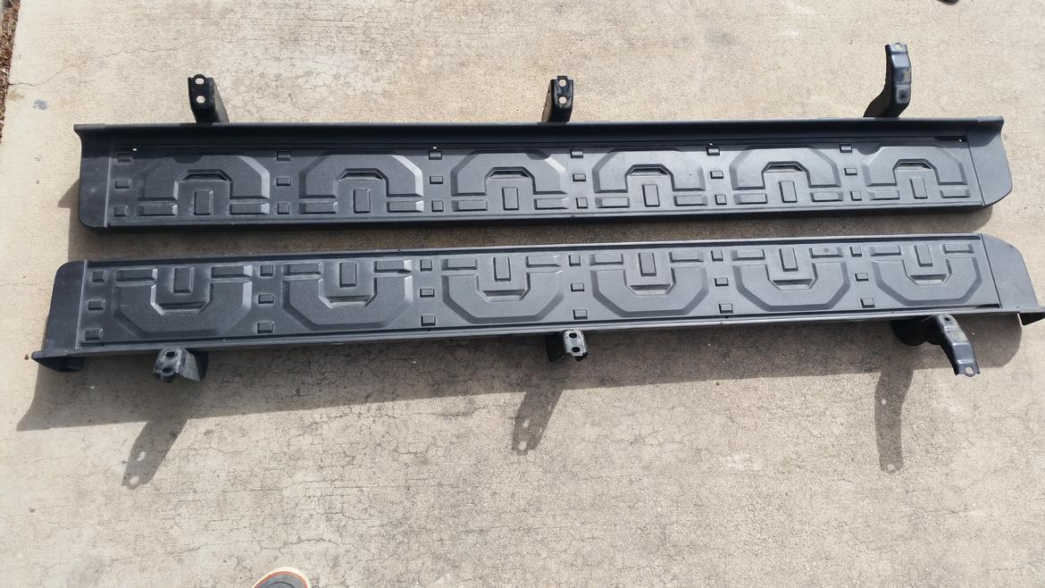

*SOLD*Sorry to hijack but I am getting rid of the running boards off my 2015 trail edition. They were on the truck for 3 months and are in great condition. I am asking $200 and the buyer pays shipping & packaging (located in lakewood, co 80227). Paypal only as form of payment.
