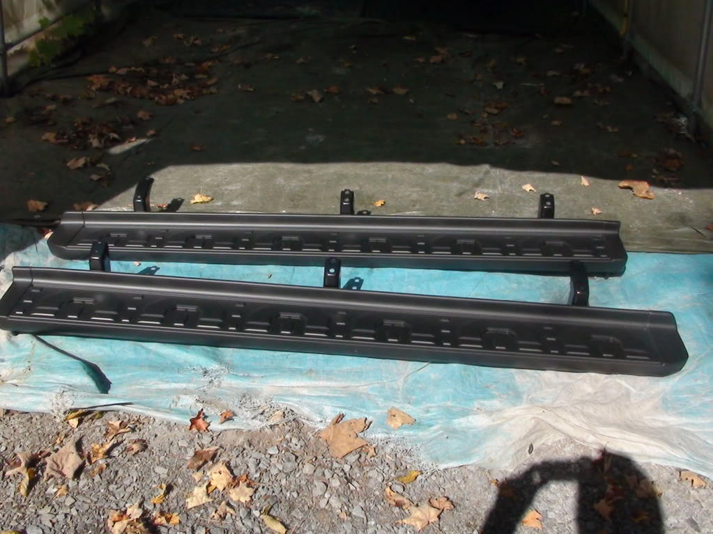

While we are at it, make me an offer. I bought a new trail premium and took the all black rigid running boards off the moment I got home. Perfect condition.

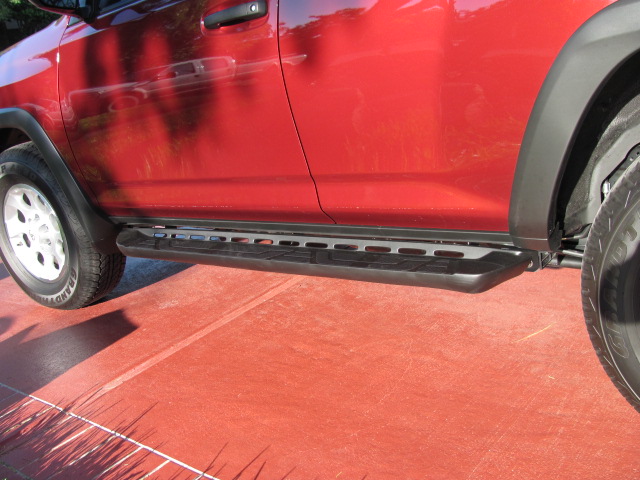

So there seems to be two stock types of the rigid black running boards- the ones with the 90 degree plastic wall that somewhat covers the gap under the rocker...
And then these that have the holes at the horizontal to vertical transition....
Which ones are what? SR5 vs Trail??

I believe the ones with the holes are pre-2012 or pre-2013. Also the door handle being black rather than red in that photo looks like the older style 5th gen. For newer sr5 and trail the OEM running boards are the ones in the first photo. The dealer tried to order the OEM running boards for my 2016 trail since no trails in my region have running boards and received the ones with holes that I didn't want and to get the correct OEM running boards they said they could only order the individual parts for the boards which was over $1000, and based on the information I could find online at that time was correct. So I bought them from someone that removed the boards from their 4runner right after they bought it.
If you want the the ones with the holes the part numbers are earlier in this thread, but if you want the newer ones I believe you have to buy them used or pay big money.
