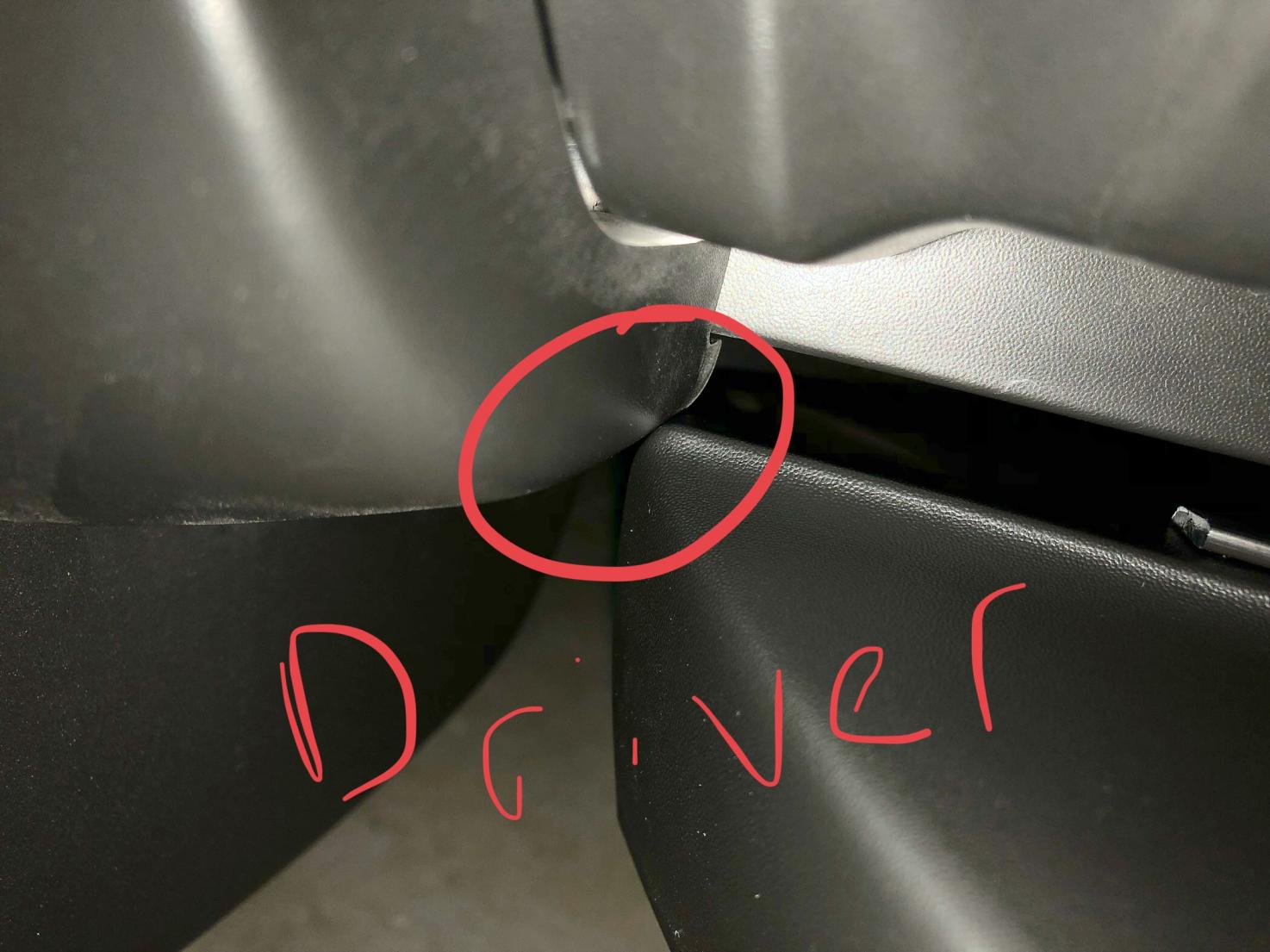

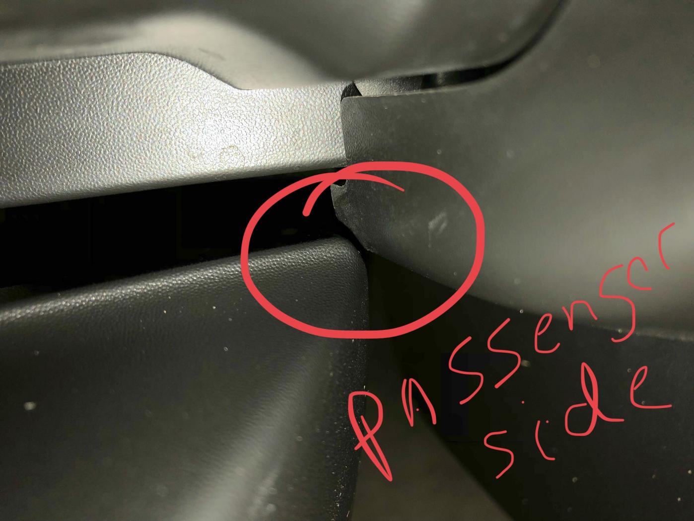

Hey guys I’m new here from Tacomaworld. I have built 5 tacos and just bought the wife a 2018 sr5 premium. I love the trail edition running boards and have had them on all 5 tacos ( like the black full step for my 8 year old special needs son) , otherwise would do her some predators!
I put them on today pt938-89100 and noticed that they barely touch the fender flare as it goes from color match to black. Barely barely only on driver side. The passenger side is close but doesn’t touch. Question I know the fender flare won’t move and the running boards won’t move so I don’t think I would have any issues down the road but wanted to see if maybe I could adjust them slightly somehow? Not lateral movement with the holes that are there !! They are the ones from 2010-2013.
Pics included

Exactly my experience with the rubbing. (2017 SR5) I was able to adjust the brackets a little bit but the boards or the trim would shift with use. I gave up and swapped them for the Predators.

Does it actually do any damage ?? If not I don’t mind :) I love these board as they will be my 6th set ( 5 on Tacoma and 1st on 4Runner ) but if it will make a spot then I will put on the pro ones!

I installed the Trail Edition running boards on my 2019 SR5 Premium and didn't have any issues with clearing the mud flaps. I did have to loosen the brackets where they attach to the running board and adjust their location slightly in order to avoid contact with the front mud flaps. This was very easy and only took a couple of minutes for each side.

That’s what I was wondering if maybe underneath I could loses the other end of the brackets not attached to the frame to adjust ever so slightly and avoid contact ??

I think you can probably adjust them enough to work. I doubt the minimal amount of rubbing would cause damage. Honestly, it bothered me more than it should have. Since I could still return them I chose to do that and install the Predator steps. If you’ve had these boards before and you know you like them, go for it. You might just need to be a little creative with your install. Post up with pics and your experience once you have them on your 4Runner.

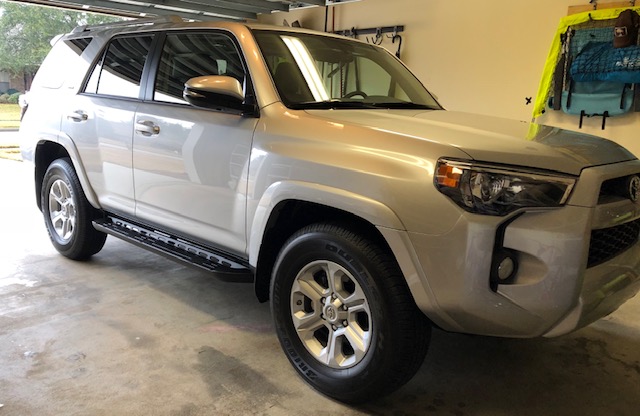

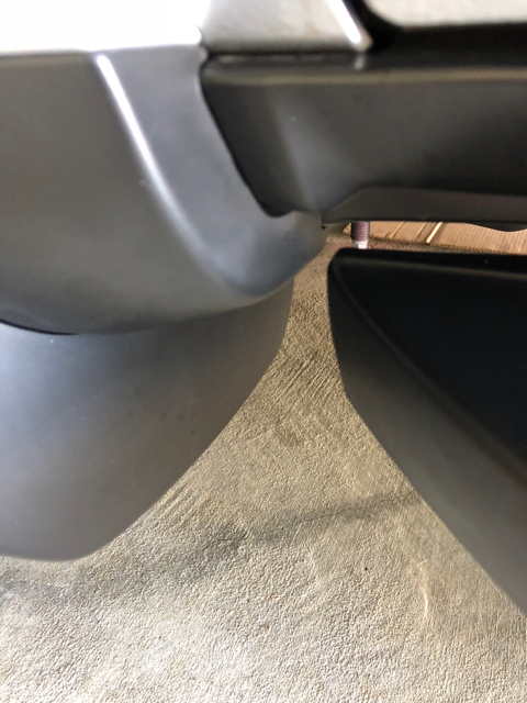

That was my pics I posted lol here it is :)

Here is a pic outside
Nice! If you are still inclined, you may be able to loosen everything up and get enough movement to clear your mud flap trim. I remember loosening it all up, including the 6 main mounting bolts and the smaller hardware on the bottom side of the step, and being able to move the boards to the rear just enough. If I remember correctly, the mounting brackets had to be angled just a bit to make it work. Then tighten it all back up. Hopefully it all works to your satisfaction.
Will be trying soon :) if not will cut off tips :)
