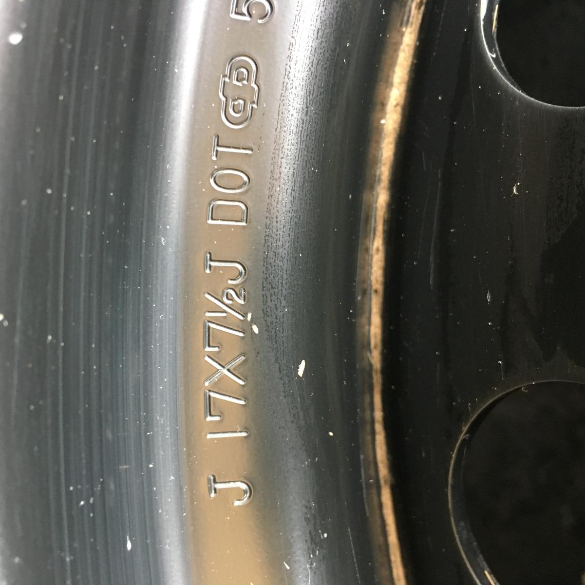

Do the Trail Editions come with a different size rim on the spare? Or do all4Runners come with a 7 1/2" Steele?

Trails come with rim's measuring 17×7.5 as standard for all tires and spare
Right, but I believe what he is asking is, would an SR5 and limited come with a 17x7.5 spare wheel as well? I'd think they would even though their normal wheels are only 7" wide.
well, I know the limited come with 20 inch rims for a spare. I'm 100 percent sure b/c my buddy has a limited, and I checked it out. So if limited and trail editions come with matching spares to their trim level rims, then I would think that sr5 and pro's come with 17x7 inch rims for spares, just to keep the electronic gizmo's happy.
But I could be wrong, lol.
Spare wheel rim size
Yes to what Mr Blah said. You need the spare to match the rim in offset and width. When you have to use it you want a tire that matches the others. Plus you want to have a spare with a matching tire so you can swap it out to the stock rim whenever you replace one tire.
Yes, the Limited does come with a 20 inch spare. it is a weird color so you can tell which one is the spare.
