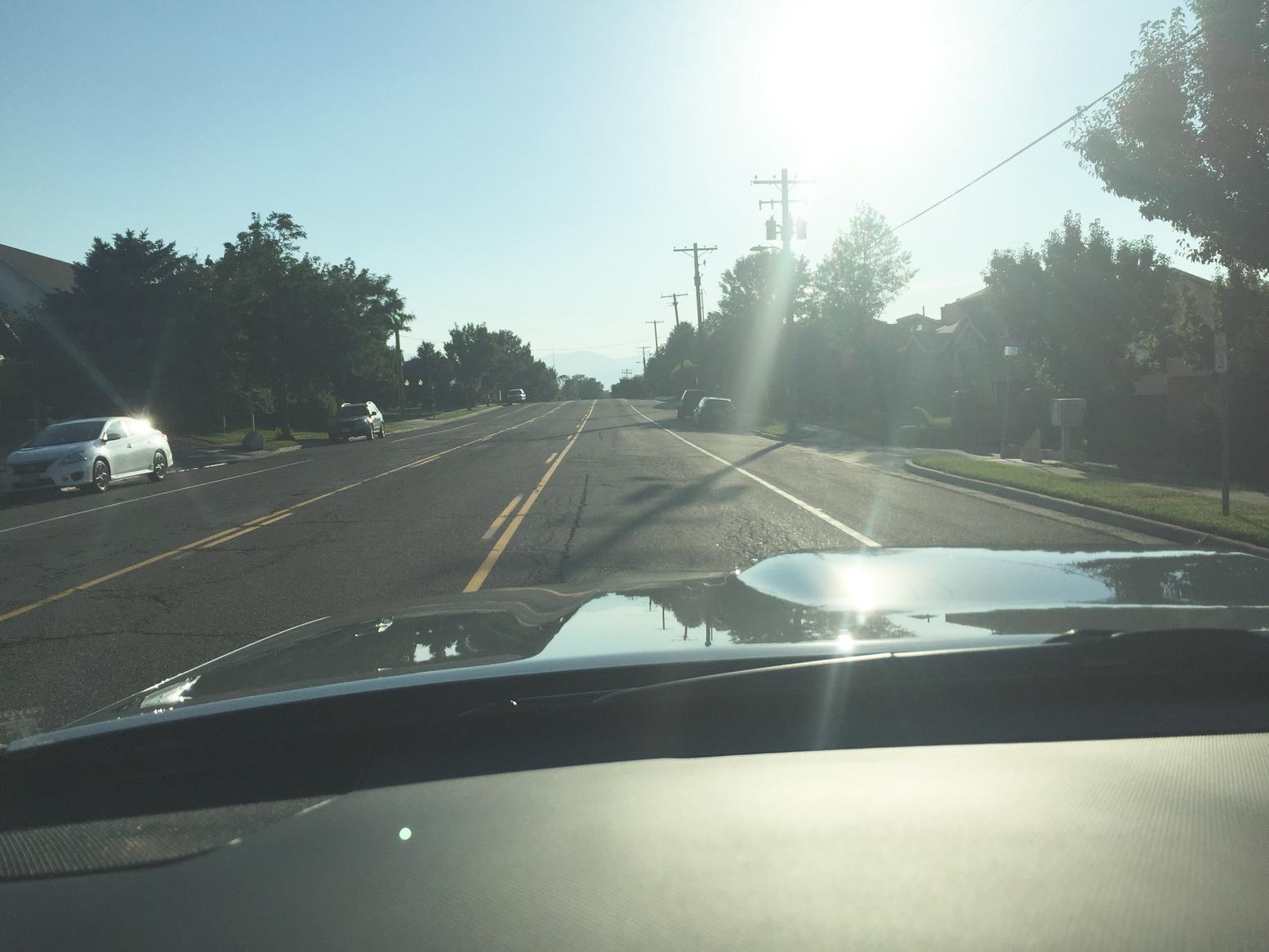

Trail hood scoop.
"these things called sunglasses"
Polarized sunglasses. I always wear them if the sun is out - probably why I've never seen the hood glare.
From Myths and truths about polarized sunglasses and glare

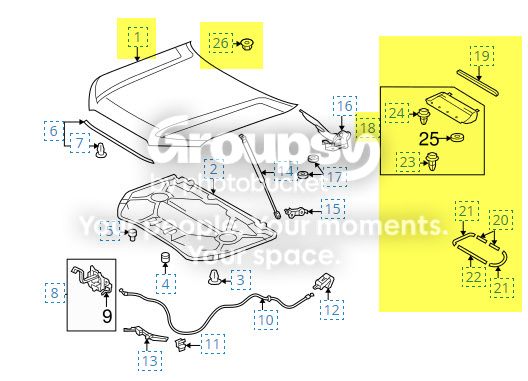

Below are all the parts you'll need for the Hood w/ Scoop. Pricing below was based from https://parts.mcgeorgetoyota.com/ Pricing may have changed as I did this purchase earlier this year.
53301-35210 Hood w/ scoop: $354
76181-35902 Scoop insert: $77.54
76182-35080 Scoop Guide: $15.35
76183-35030 Scoop protector: $1.14
76183-35040 Scoop protector: $1.14
76185-35030 Scoop protector: $2.02
90080-17189 Scoop Nuts (4) qty (4 x $1.46): $5.84
Total: $457.03
Add in painting the hood at your local body shop around $400+
Just confirming this is the total number of parts needed to make the change to a hood with scoop? I have a 2016 SR5 coming.
And big thanks [MENTION=149619]Ride4Runner[/MENTION] for putting it together.
Yes all the parts below are what you need to do the hood w/ scoop conversion.

#1: 53301-35210 Hood w/ scoop: $354
#18: 76181-35902 Scoop insert: $77.54
(Should already come with the plastic clips #23 & #24 (no need to order), mine did when I ordered the Scoop insert)
#19: 76182-35080 Scoop Guide: $15.35
#20: 76183-35030 Scoop protector: $1.14
(Should be (2) small felt strips in the package)
#21: 76183-35040 Scoop protector: $1.14
(Should be (2) long felt strips in the package)
#22: 76185-35030 Scoop protector: $2.02
((1) long felt strip)
#26: 90080-17189 Scoop Nuts (4) qty (4 x $1.46): $5.84
(Order (4) as each nut is sold separately)
Picture below of parts #18 thru #26 from above, except #1 the hood w/ scoop.
Enjoy the new hood w/ scoop!
Hood1_zpsurrdqamu.jpg~original

Thanks so much!! I'm wondering if I could just have my shop cut the damn hole in my current hood, would split the difference in hood cost and save me on paint, though they'd probably want to re-paint again.
You can't just cut the hood for the scoop insert. The hood w/ scoop has the scoop hump stamped in the metal. See the differences below
Scoop with hump:
images
No Scoop, flat:
I've had mine since Dec, so granted, a lot of my driving has not been when it's super sunny. Though in eastern WA state we've had a ton of sun the last couple months and I have literally not seen any glare on it as of yet. we'll see how it is the rest of the summer.
Well I do have to admit, I experienced glare for the first time (driven this rig from dec-present). It was annoying, But only lasted a little bit while I headed in one direction. Once I turned it was fine.
Back in the 60's when the muscle car was born there were lots of cars that had hood scoops of different sizes and functions. The glare issue is not new and to solve it then, many painted their scoops a flat color to cut the glare. Just a thought!
Jayhat, I'm in Spokane and if that glare ever gets too annoying let me know and I'll trade you for my superwhite non-scoop sr5-p hood!

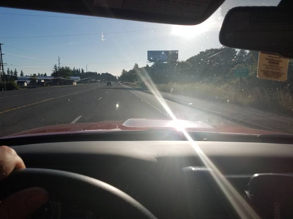

Experienced the dreaded hood scoop glare for the first time today...I kind of dismissed it before and thought "how bad could it be?" It's pretty bad.
I was trying to do the same for my SR5 Premium. No luck. Only cheap looking after market parts. If you find something that looks decent similar to the TRD, please post it. I think it is more for looks.
I experienced the glare for the first time the other day, driving west into the sun at about 7 p.m., when the sun was 10-15º off the horizon. Polarized sunglasses didn't help.
I could see it getting annoying if my commute took me along a westward route at the same time every evening, but I can live with it being an occasional thing.
