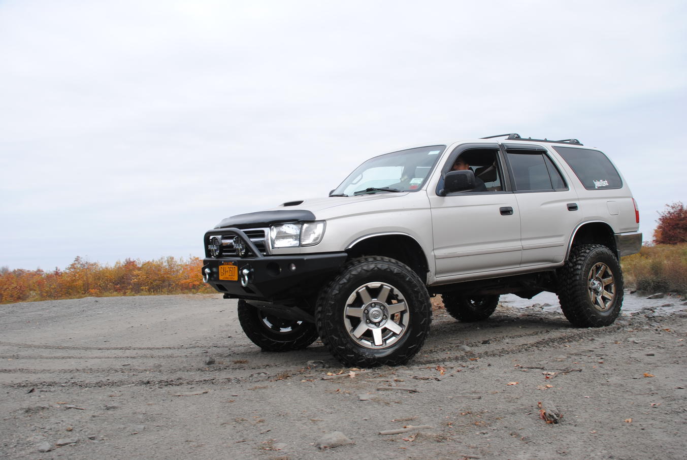

They're overrated!
I knew that. Duh. Just being lazy. Thanks for the pics.
I am not sure I like the stock front bumper look as much as with an ARB or the like. Still mulling it over.

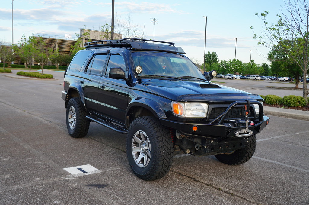

DSC07434 by Unner Unner, on Flickr
Thanks Unner. You must really stand out at work even at BMW. My boss's brother drives a X5 M. Tasty, it is.
What would really solve this dilemma would be to have two 3rd gens, one for the sensible me and then one for the never aging teenager in me.
Nice. Are you running a body lift? Wanting to put 315's on mine. Did you have to run wheel spacers?
No body lift its all suspension (See Below)
Lift Setup:
-Front:
Tundra Bilstein 5100s
Eibach 3 inch lift coils
Set on the second perch
-Rear:
4th Gen 2 Inch Lift Bilstein 5100s
LC 8 Wraps
-Hub to Fender:
F: 23 3/4"
R: 25"
I have also trimmed then folded the pinch welds and put on Light Racing UCAs
Had them on with stock arms for a bit but then got the UCAs to dial in the castor to remove all rubbing.
Had to use 1.25" Spidertrax Spacers to get the wheel/ tire on with the stock UCA and even had to use them to clear the Light Racing ones that are thinner in that area.
315s will run smaller than 35x12.5s so you will have a bit more room.
Hope this answers your questions but if you have anymore just let me know.
