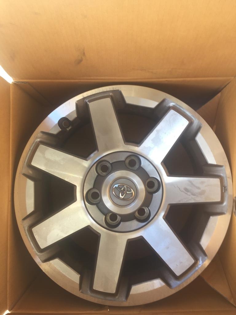

I have a set of perfect Trail wheels for sale if interested
