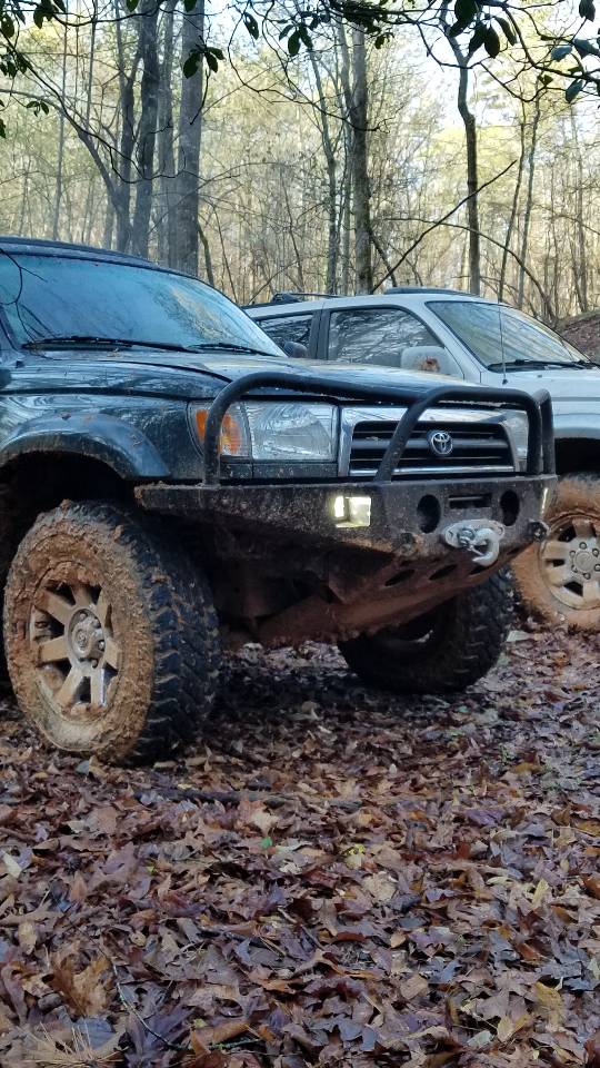

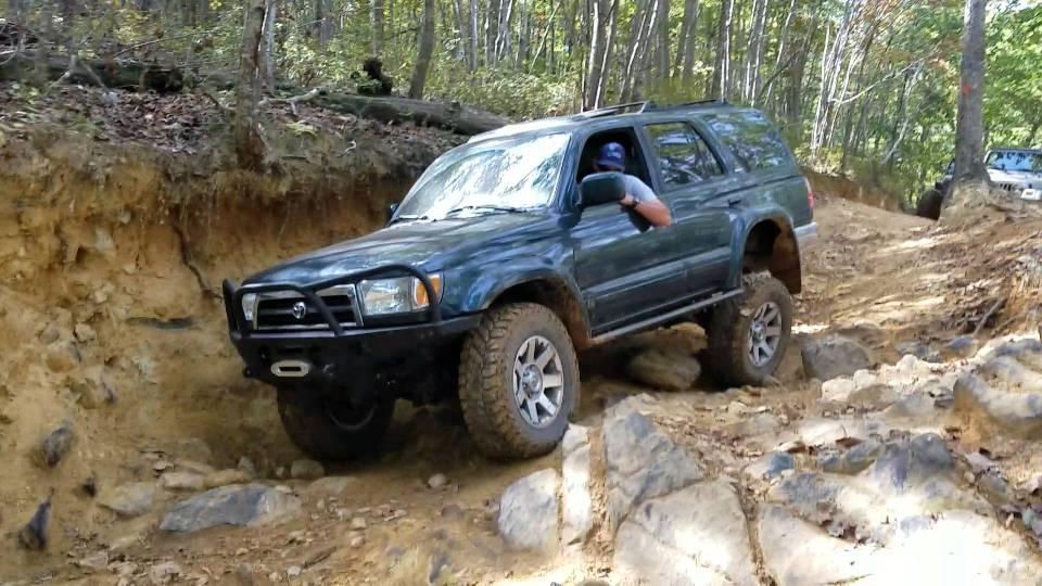

Had to sell my rig, but I absolutely loved my ‘17 TRD off-road wheels
255/80/17 Nitto Trail Grapplers, bilstein 5100 front and rear
