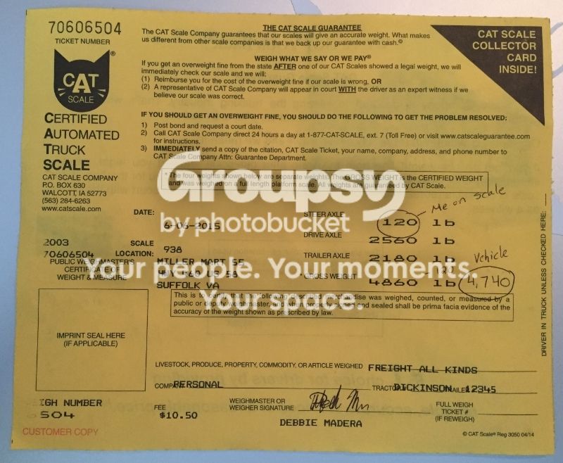

Okay,
So I got some weights yesterday.
Vehicle weight - 4,740 lbs
Camper weight - 2,860 lbs
Tongue weight - 400 lbs (weighed yesterday at RV dealership)
Apparently I'm an idiot and didn't realize GVWR and GVW where two different things.
The Toyota manual states my total GCWR (Gross Combined Weight Rating [truck and trailer]) isn't to exceed 11,300 lbs. So I was adding my two GVWRs together getting 10,000 lbs or so thinking that only leaves about 1,000 lbs for passengers, camping gear and modifications. Well, I weighed my stuff yesterday and came up with some answers.
Please forgive the scribble mess, but I've never used these scales and had a little trouble deciding which scale sections to park in the first couple times.
Here is the 4Runner weight:

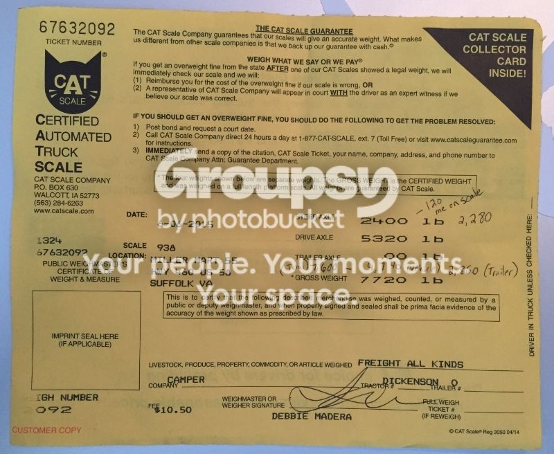

Here is the combination of trailer and truck. If my math appears incorrect please feel free to let me know (I know you will- hahahahah).
So my question is at this point if anyone cares to chime in...
I drove the camper for about 3 hours yesterday. There was a clear bucking. Like a push and pulling back an forth between the camper and T4R while driving. I've noticed this before on my other vehicle and it's totally manageable, but seems that may be an indication of something. MAYBE it's totally normal. I'm just curious what you guys think.
Can anyone add some opinions on that?
