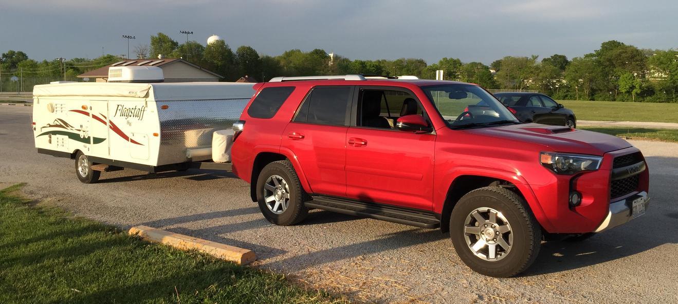

I have the same pup. HW27SC. Granted I have a 3rd gen but you are saying you aren't getting any rear squatting when you load your pup? Do you have a pic hooked up? Just curious.

Sorry man, I don't know what a "pic" is, but I didn't notice squatting until I looked at this picture. Yea, apparently there is a pretty significant amount of it.
That's some serious sag.
I'd invest in some stiffer, beefier rear coils and get an anti-sway system.
Agree, your headlights will be in oncoming eyes. Plus that nose up attitude upsets everything; steering, braking, etc.
What else will be in the 4R? People? Gear? This will only make it worse. ALL 4R's are softly sprung. Many on here like airbags.
Please answer: What is your loaded/as towed tongue weight? It should be 10-15% of the trlr wgt. Your truck doesn't look right.
ETA: Looked at your pic again, it does not look as if your truck has any ppl or gear in it.
Don't forget to pump up them tires.
I have a hybrid Toytec lift, and with almost 1800 pounds of crap in my truck plus my fat 240 pound ass there was only 1.5" sag--since I have it set on a rake the vehicle was sitting level.
Trailering with a heavy tongue weight also has the same effect.
Sorry for the attached photo, but the image link doesn't appear to be working for me. Anyway, this is when we brought it home. Empty, but the truck had stuff in the back. Now that it's loaded, it has a hair more sag, but it's still decent. However, this truck will probably have a lift in its future, so some stiffer springs will be in order.
Again, this photo is without any weight distributing hitch or accessories. The only thing I have installed since then is the Reese antisway.
(Previous post)
"So I got some weights yesterday.
Vehicle weight - 4,740 lbs
Camper weight - 2,860 lbs
Tongue weight - 400 lbs (weighed yesterday at RV dealership)"- Approximately 14% of trailer GVW.
My understanding is the max psi for my tires is 35. I'm at 33.

As far weight placement I completely understand the importance of balancing weights property. It's especially important in flying (I'm a private pilot). There just aren't a bunch of options for changing the weight around in that camper. The racks are fixed on top and the boars aren't going anywhere. So that's a done deal. The inside has some items stored under the kitchen table bench and some items in the shower, but not a lot of weight. I do have some items stowed in the back, but since my tongue weight is 14% I'm assuming nothing is grossly off here. Not to mention I didn't have any major problems driving it although it was not windy and 3 hours of flat land driving.
I'm going to get that Fastway/equal-I-zer e2 hitch to be safe. Unless someone on here can tell me something convincing otherwise. I didn't even notice the sag in the back until after I took the picture. It just wasn't that hard to drive. Just some minor "bucking."
