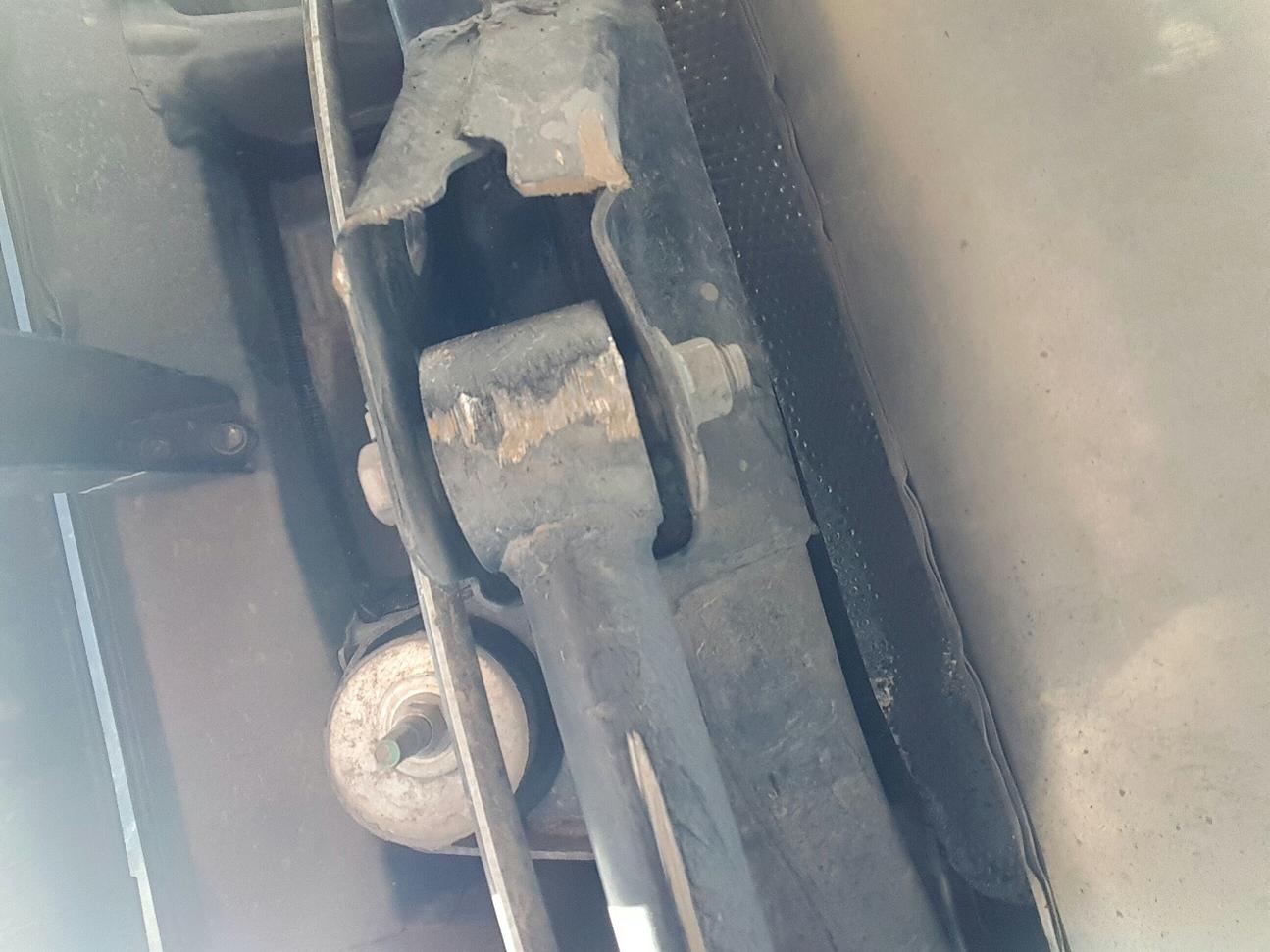

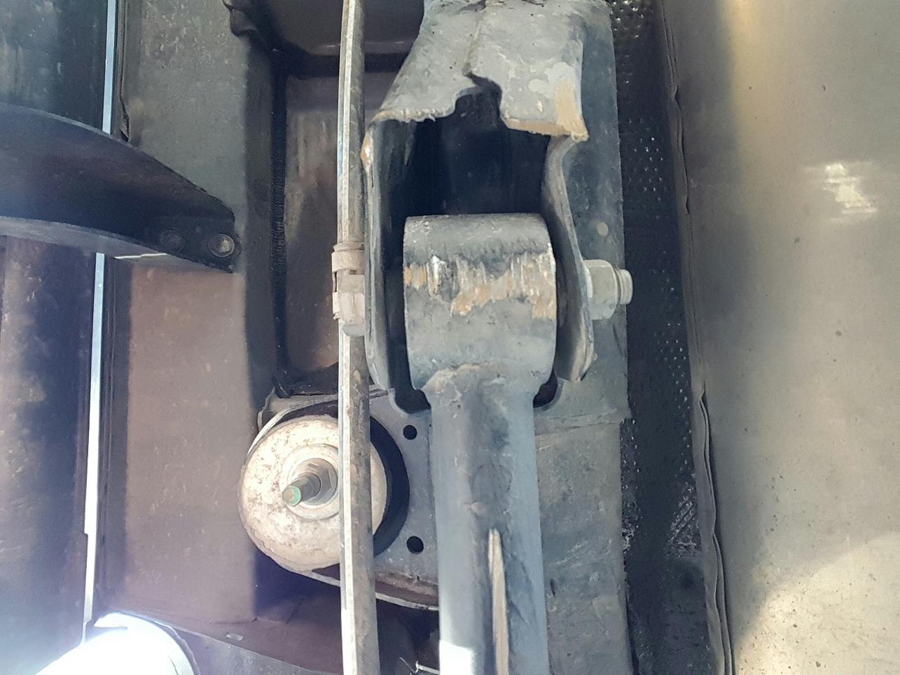

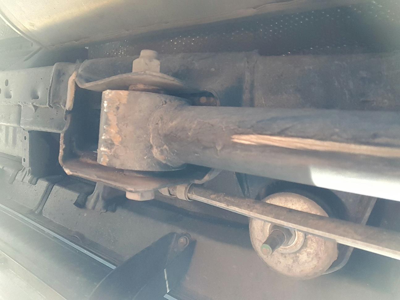

Took my '15 TEP on its first trip to Rausch Creek this weekend for the 101 course. The entire experience was great and I highly recommend it to anyone that is interested. It was a little more "extreme" then I expected, the skids took some hits and I don't think the factory running boards will be staying on much longer. The real victim seem to be the passenger side lower trailing arm mount. Doing an inspection to check for damage today and it looks pretty bent to me. I don't remember exactly how it looked before so I don't have nay comparison.
So I guess I have 2 real questions. First is this something I really need to be worried about? Drove it home 225 miles and I didn't notice anything was wrong. And second, does anyone have a picture of the undamaged mount for comparison.

That looks pretty bent out of shape. Can't you compare it to the other side for reference?
Also, I would guess it being bent out of shape would mess with your rear alignment. Not a 100% sure though. So I guess skid plates for this spot can be useful.
I doubt it has effected alignment. Might make that bushing wear a tiny bit faster. I wouldn't worry about it....
The drivers side mount is not exactly the same shape as the passenger side. Even more so now....

I doubt you have any major issues now. If a skid will fit I would just leave it alone. If not, get it straight again. A fab shop should be able to align it straight again.
Really hard to tell from pictures... BTW, most people call this the rear Lower Control Arm.
easily repairable with a 5lb sledge hammer, maybe two. You have to hammer and dollie the metal flat again, after removing the trailing arm.

I don't see any concerning damage
