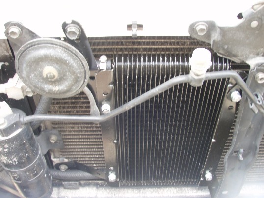

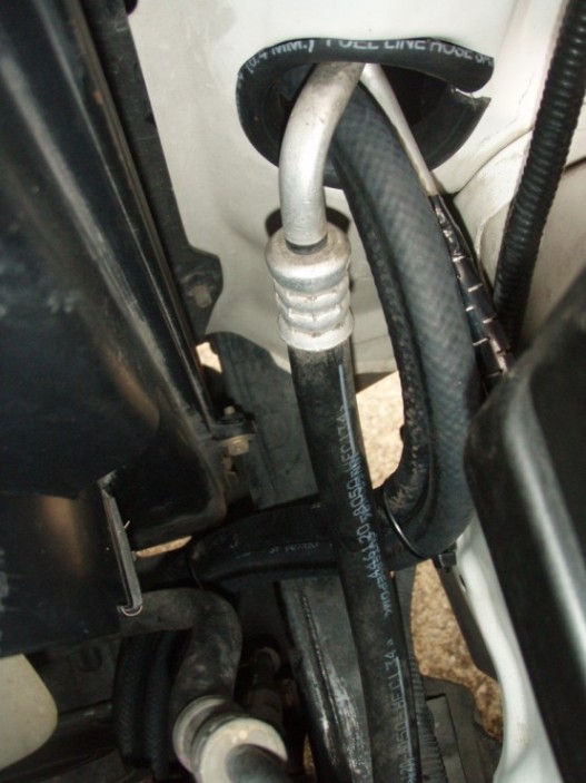

B&m 20768

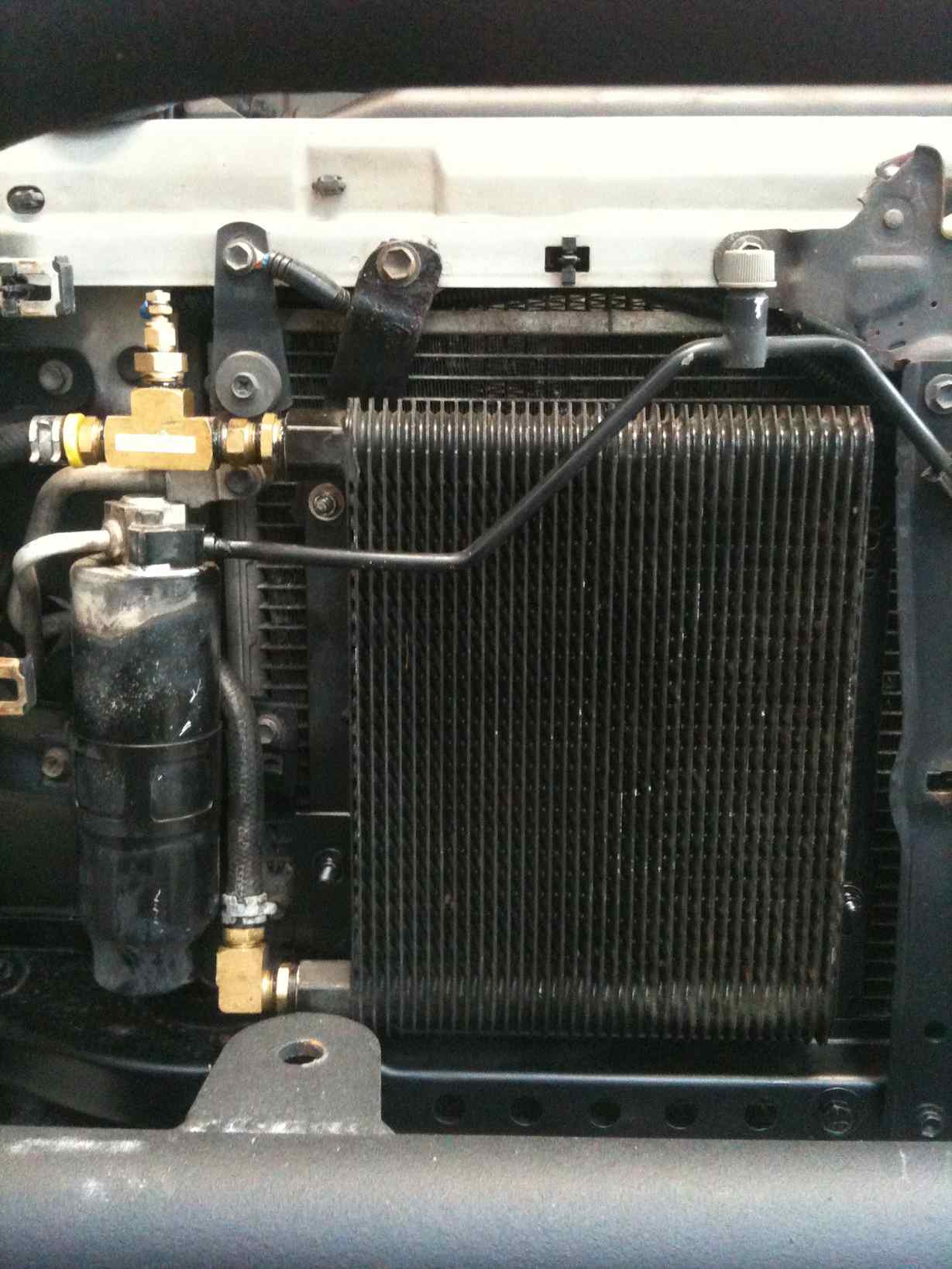

B&M 70274

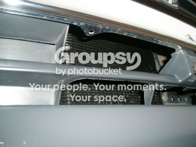

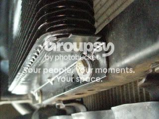

These aren't the best pics, but this is where I mounted mine, behind the lower plastic bumper valence.
P1010033.jpg~original
P1010085-1-1.jpg~original
Probably should have mounted it closer to the condenser, but oh well. The cooler is kinda big but the weather in Hawaii is pretty warm for the most part, at least compared to the mainland that is.
thats what im having trouble with.... deciding on which one would be best for me...i dont do any towing or offroading....its just a dd
Well, I say too big for just a dd, but no one knows the actual BTU rating of the OE cooler. So when buying an auxillary cooler, all you do is guess wether or not it will be undersized, adequate or overkill. All any of us can do is report on how their cooler works, in their climate with their driving habits. The only actual recommendation for aux coolers I have ever seen was from B&M. They say if you are using JUST the aux cooler and NOT in conjuction with a radiators cooler, to use the one I have. That being said, I dont think anyone has reported ill effects with the smaller ones in normal driving conditions.
