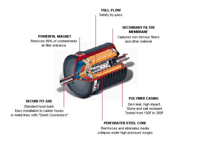

Yup same ATF-3 Only. The pan filter isn't much of a filter, its got bigger holes than your average window screen, i wouldn't bother with it. Draining only uses about 4 quarts, so drain/fill, drive a day/week/whatever the repeat once more. I also use a magnefine filter (real filter plus magnets), on ebay for about $12. Good cheap insurance. Luck! :banana:
