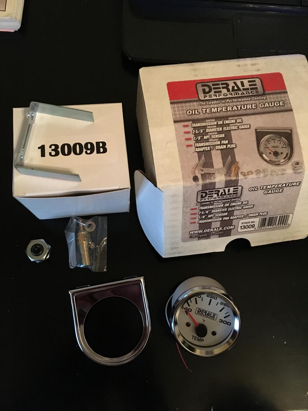

Since I'm about to embark on this as well (as you know since I saw you post on my thread and thx) I did think of one other thing...
If you are going to drop the pan and do full service on the tranny it would be a good time to put in a bung for a tranny temp gauge. Not necessary at all but just would be a good time and they are not that expensive. I'm going to do it...at least get the bung in there and then run the wiring and mount the gauge later. Plus most of the bungs are bolt on with an inner section that threads out which also doubles as a future drain plug.
Not sure how I'll mount it yet and that is a source of endless debate but for me obviously as out of the way as I can but hopefully in a way that will still let it drain most of the fluid in the future. Also, even if I don't have it on the "hot" or "cold" side (as again there is endless discussion about) I figure it will still be better than nothing and provide a baseline of how hot I'm running in different conditions, when towing, etc.
Some guys that REALLY want to get fancy will put the bungs on the output and input lines to see how well their cooler is working. I'm not quite that ambitious.
