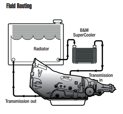

doesnt sound like a major issue running just the aux cooler & being you are in socal the extreme cold of winter temps shuldnt be an issue, but keep in mind the rad cooler is always better to keep hooked up & use the aux cooler in series with it. one thing to consider is when towing or super hot outside temps & prolonged driving is that the aux cooler doesnt provide any cooling at lower speeds or when stopped like in traffic jams or off roading climbing hills etc. that is where the rad cooler is needed & being liquid cooled its much more efficient at removing heat than air cooled.
running too cool with just an aux cooler is an issue but just as much if not more important is running too hot in situations where the cooler cant get proper air flow & when out driving or especially towing you never know when that can happen.
did you determine why the rad cooler was leaking? could have been a loose fitting or bad clamp/hose, could be an easy fix to get the rad cooler hooked back up or worst case scenario a new denso radiator is about $100 & a quick & easy change, if the rad is higher mileage or has a leaky trans cooler issue, a new rad would be the best option IMO.

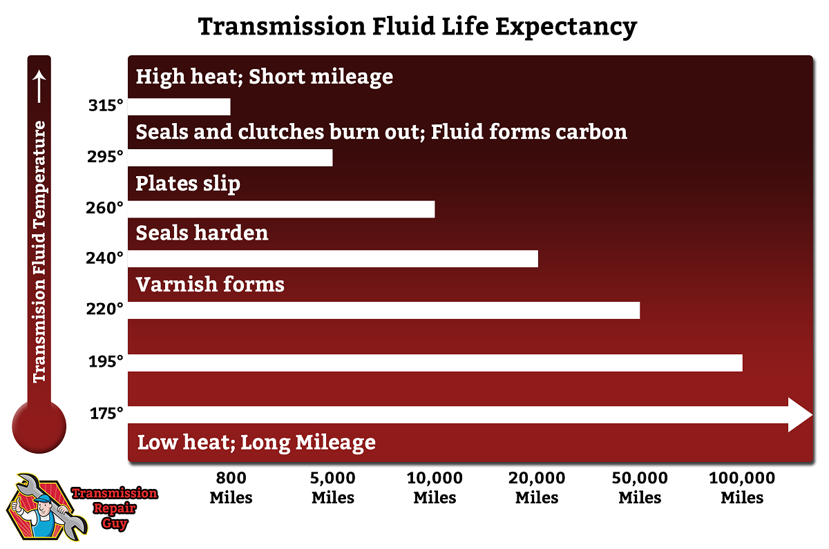

im sure you have seen this but for those that haven't here is a trans temp chart & diagram of how every aux cooler company recommends installation.
