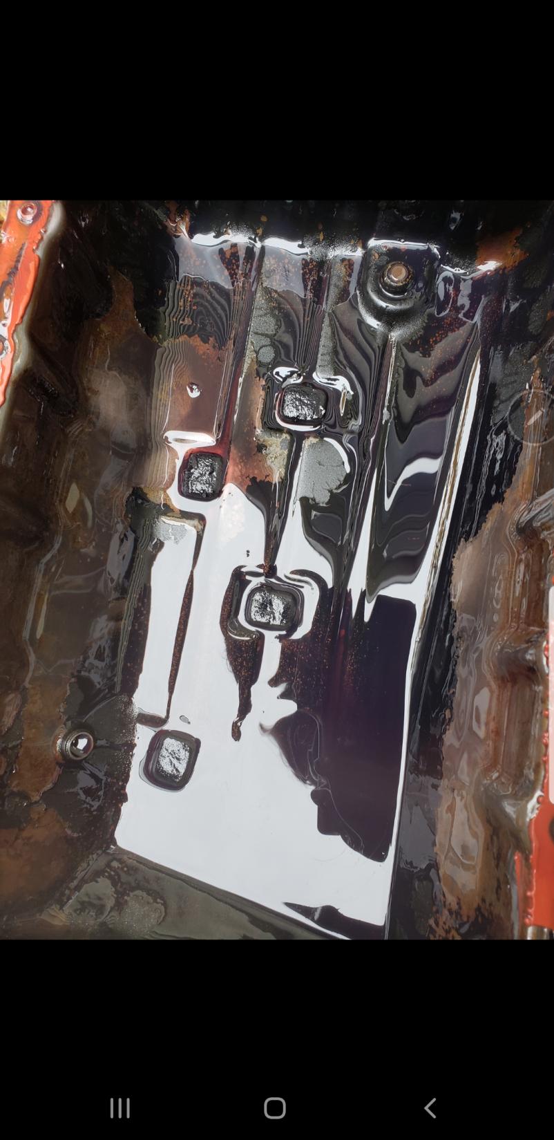

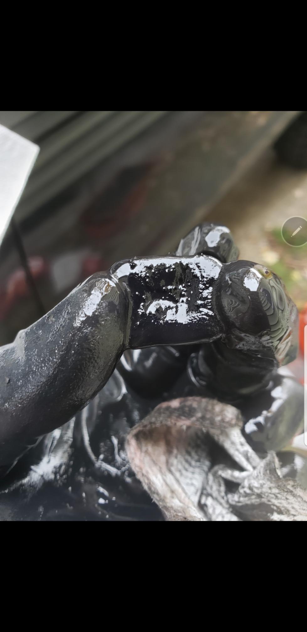

I completely cleaned the magnets to make them look brand new as well so well see what's going on! Btw I race in 4lo on a sand drag strip at the silver lake sand dunes and this thing kicks ass. I rarely lose unless someone has some crazy mods. Anything stock jeep wise or truck wise I dont lose to. Trans revs out to 5500rpm through all gears no problem. Lol time and time and time and time again. Fun stuff. Parts are a dime a dozen out here I'm not worried about breaking anything. I just dont want to end up on my back in the middle of Michigan winter doing a trans swap in my garage

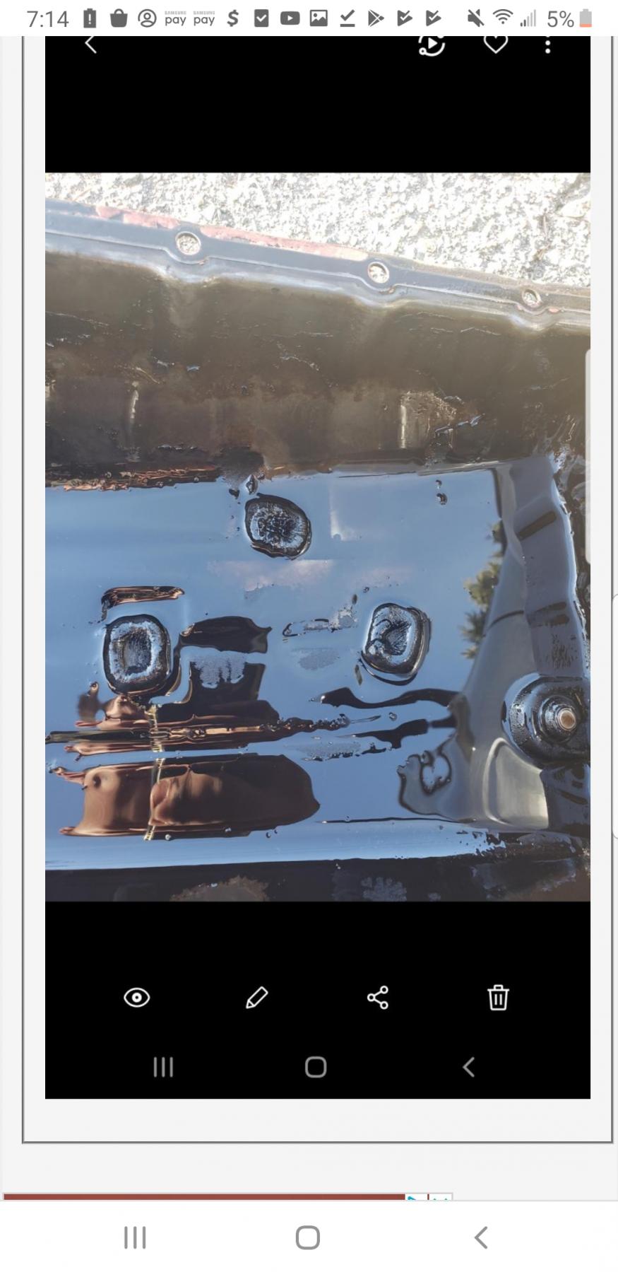

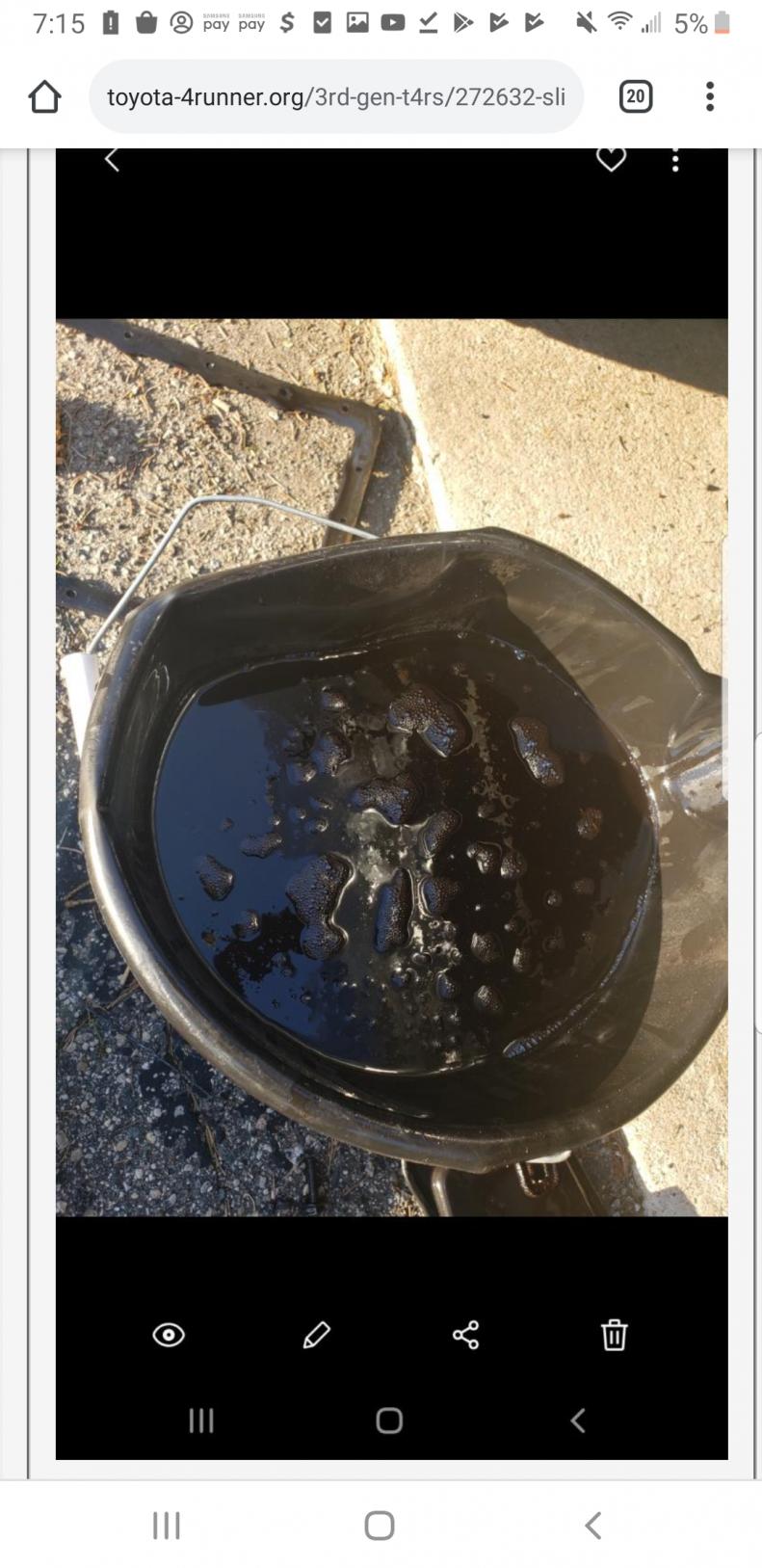

Well I swapped the filter and all three solenoids and the check engine went off the trans noise went away and it's looking pretty clean! These transmissions are really bulletproof! Magnets were dirty again but no chunks of metal just sludge. The last filter swap did its job and so did the magnets. I'll revisit it again in the spring and if anything flush the fluid and install another filter. Rinse and repeat untill shes clean!

When was the last time the magnets cleaned? How many miles?
Sent from my SM-J337V using Tapatalk
I would be looking for spare trans with lowish miles and never been cracked open. that is a lot of clutch material IMO.
I did not take pics of the pan but... this one 240K miles and never been cracked. fluid was a little black but still had some red in it.
https://www.toyota-4runner.org/3162709-post2.html
the pan had no where near that amount of build up on the magnets.
also? why is the paint missing on the inside of the pan? did that trans endure some crazy high heat?
I know when I cracked open my 98 with 215k on the clock my magnets didn't look that bad. I agree there is a pile of material being gathered. My Transmission was never opened before then and I bought it off the Original owner. My fluid had a tint of red left in it and the metal screen filter was clean.

Maybe it will last quite a while yet and only time will tell. The way its producing material especially metal this should be interesting.
