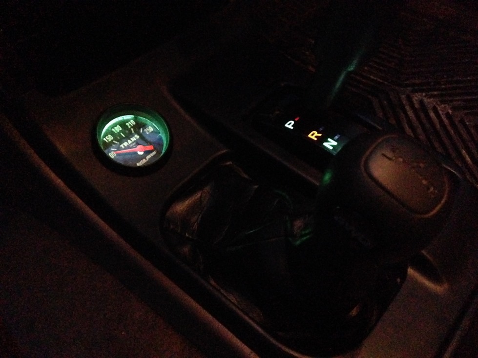

How did you get your gauge to fit all the way in like that. I have the AM 2640 and It's a really snug fit back there. I had to pop the gauge out a little bit to get the panel to clip down, and that's without the mounting bracket on the gauge.
You gotta move the crap behind it out of the way.
So the stuff that's there can be moved? I didn't take the time to take a closer look at what that block of stuff is.
Found this pic (not mine). I guess that's what's there, but I didn't remove all of the foam surrounding the area.
P1040432.jpg~original
So there's wiggle room to move this crap out of the way?

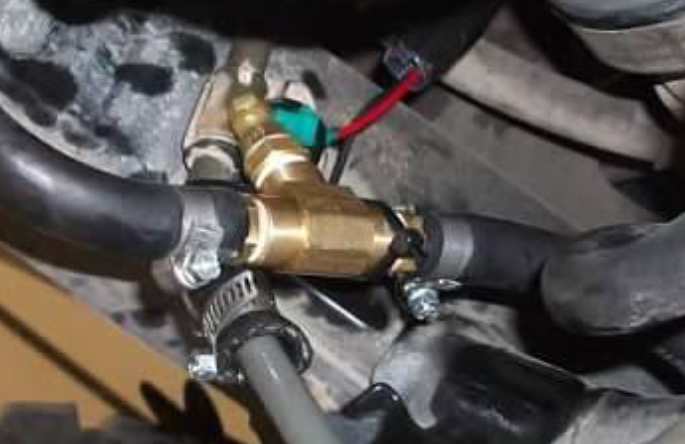

How did you actually connect or splice it in? Did you use a T with one end connected to brass/steel union coming out of the tranny, the other end to teh steel cooler pipe running to the rad, and the third end received the temp sender?
I am having the biggest trouble with this!
Your hardware store will have a 3/8" T and barbed 3/8" male fittings(2). The sensor goes in the leg of the T. Just cut out a section of the rubber hose big enough to accomodate the T fitting. Use teflon pipe tape (gas resistant preferrably)

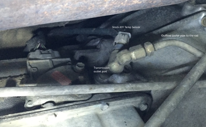

Aha, I see. So you spliced it into the flexible hose near the rad, rather then into the metal pipe or the union that comes out of the transmission? (the one that receives the stock ATF temp sensor) See image
