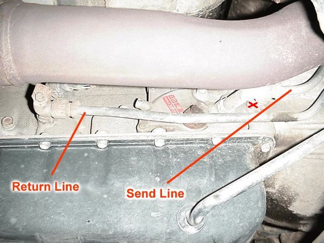

I guess it would be important to know where everyone is sensing their temp from. The trans factory temp sensor position is inside the trans and is rumored to sense oil temp comming from the torque converter.
Putting a temp sensor in the cooler line comming from the trans to the cooler is basically measuring oil pan temp cause the flow is pan to pump to cooler to trans. And the coolest readings would be putting the sensor in the return line after the cooler.
my '99 temp sensor takes its reading where the fluid is hottest, just before it flows out of the case and into the send line. red X in photo.
from member kball http://www.toyota-4runner.org/605605-post4.html:
Most transmissions pump fluid out of sump and to the cooler. From the cooler it goes to the valve body and does its work.

On the jeep forums I'm reading that the oil pan oil is post cooler on the AW4 which is basically the A340. So I found a AW4 service manual pdf and am looking for the hydraulic schematic to see where the cooler is in the oil path.
Have you removed the sensor and blew air into it and seen air blow out the trans cooler line?
My '99 (and subsequent year 3rd gens) sensor doesn't just trigger an idiot light at a preset temperature, it measures the actual temperature and sends this info to my scanguage. I believe it is located so that it measures the fluid at its highest temp.
I think the reason trans fluid temp is relevant is because it starts to break down at an increasing rate above a certain temp, which shortens its service life. So the temp after it is cooled and it enters the trans isn't relevant. The highest temp at any given time is what's relevant.
