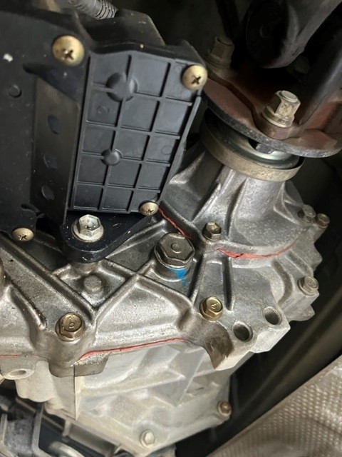

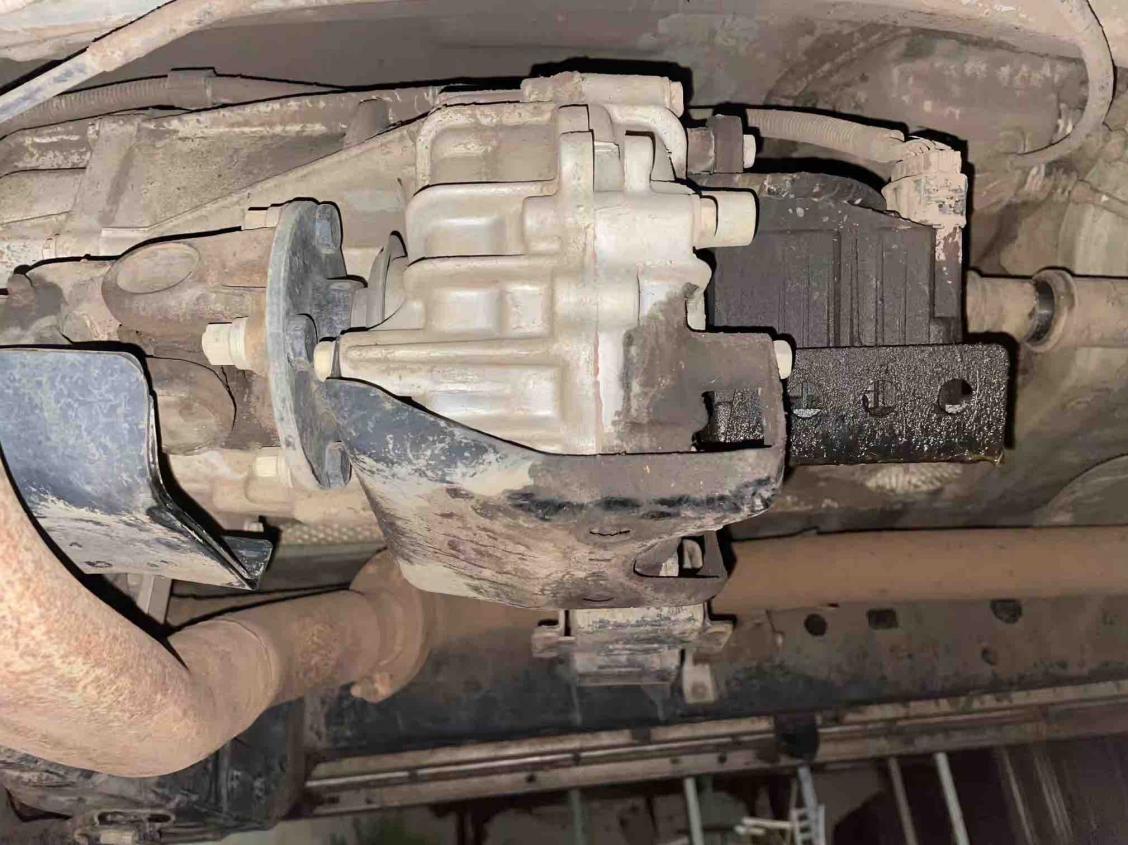

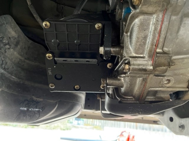

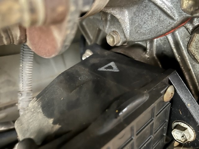

I haven't had a single leak in the 1,500 miles I have driven the truck until this weekend. I went offroading and camping, upon returning I noticed I was leaking a bit of oil in the driveway. I'm not a big car guy, but I've determined that what I'm seeing is a leaking actuator in the transfer case?
1) Since I was using 4WD and switching in and out a handful of times, it seems like it would make sense that this didn't start til I went out and wheeled a bit..
2) Hoping this isn't a $2K fix, but I am not very hopeful.
Anyone out there able to take a look at these photos and let me know how bad you think it is? Going to call my mechanic today, but this forum is always of immense help.

Review the previous posts and write up. Then you or your mechanic should have a good idea of what to expect. Do it yourself and your cost is almost zip.

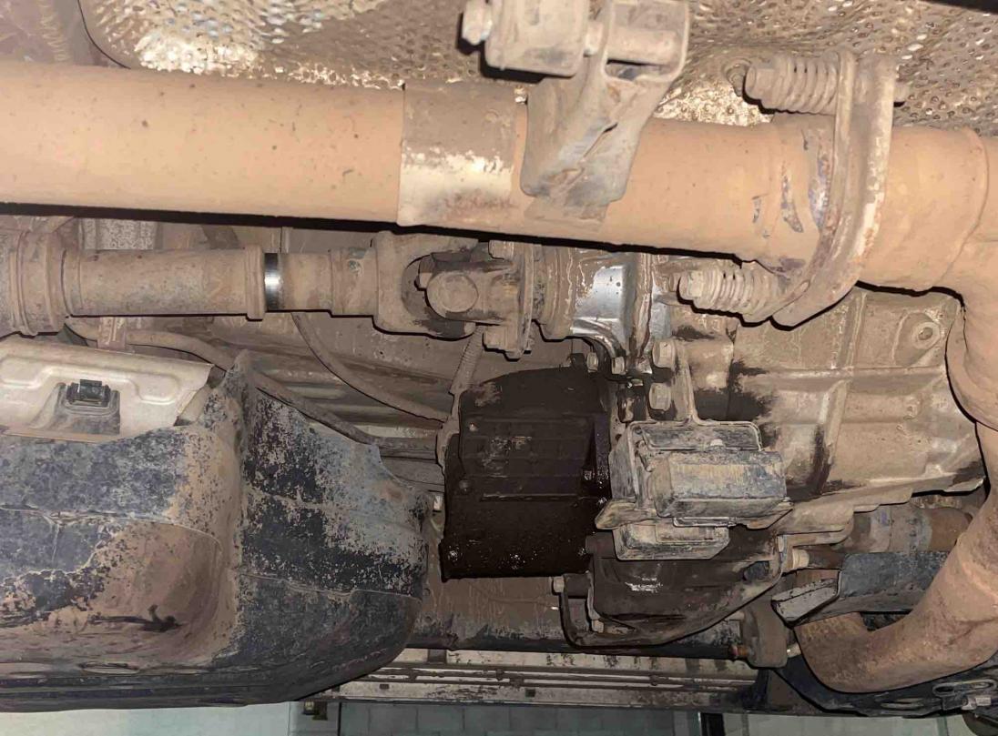

The mechanic got this on a lift and showed me where the leak is coming from. Looks like the seal between the actuator and the tcase.
Is that the same seal that everyone else is taking apart the tcase to fix?
Just making sure I am looking at the same issue as the one posted. Thanks!

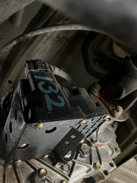

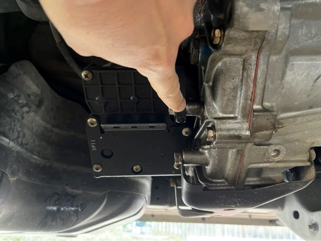

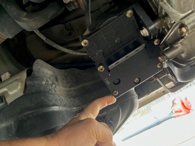

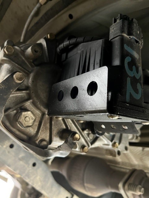

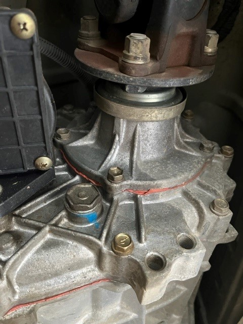

Just found a leak under my 2003 Sport V8 4x4...only 96K miles...
Is this the actuator leak? I have a half-dollar size spot on the driveway from about 2-weeks of siting and leaking.

Scheduled with the dealer to do the repair. Quote is $1100. Not leaking very much, but with only 97k miles, all else in great shape, it is worth it to keep all in in good working order. I'm going to speak with them about the double O ring idea. FYI...breather tube is also dry and cracked and not attached. I taped it for now but will ask for a new one in addition.
My 4Runner is at the dealer for the actuator seals repair. As it turns-out, the plastic of the actuator case is deteriorated and that is where the leak is. Edge of the round area that is around the shafts.
Don't know cost as yet for a new actuator or if a repair, actuator component can be had/installed.

Had to replace the actuator which requires removal of the transfer case. Dealer did the job and did a great job!
I'll need to look back at the cost, but it was spendy.
