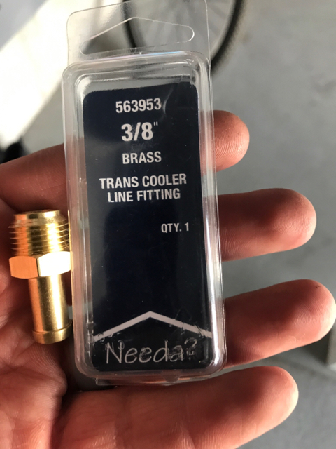

I should have added this in the first part, but is the stock t case cooler under more pressure than a normal trans cooler? The stock unit uses banjo bolts, and double flare hard lines. All the aftermarket ones I’m looking at are hoses with slide in barb fittings and hose clamps.
Ok. All you need to delete/replace the hardlines and extend or shorten the hoses to the transfer chain case cooler is two of these.
If you need to replace the cooler you can use these as well and not mess with the banjo bolts. I don’t know why this took me so long to find, even EVCO didn’t know what to give me. It’s just a 3/8 flare fitting with a hose barb.
