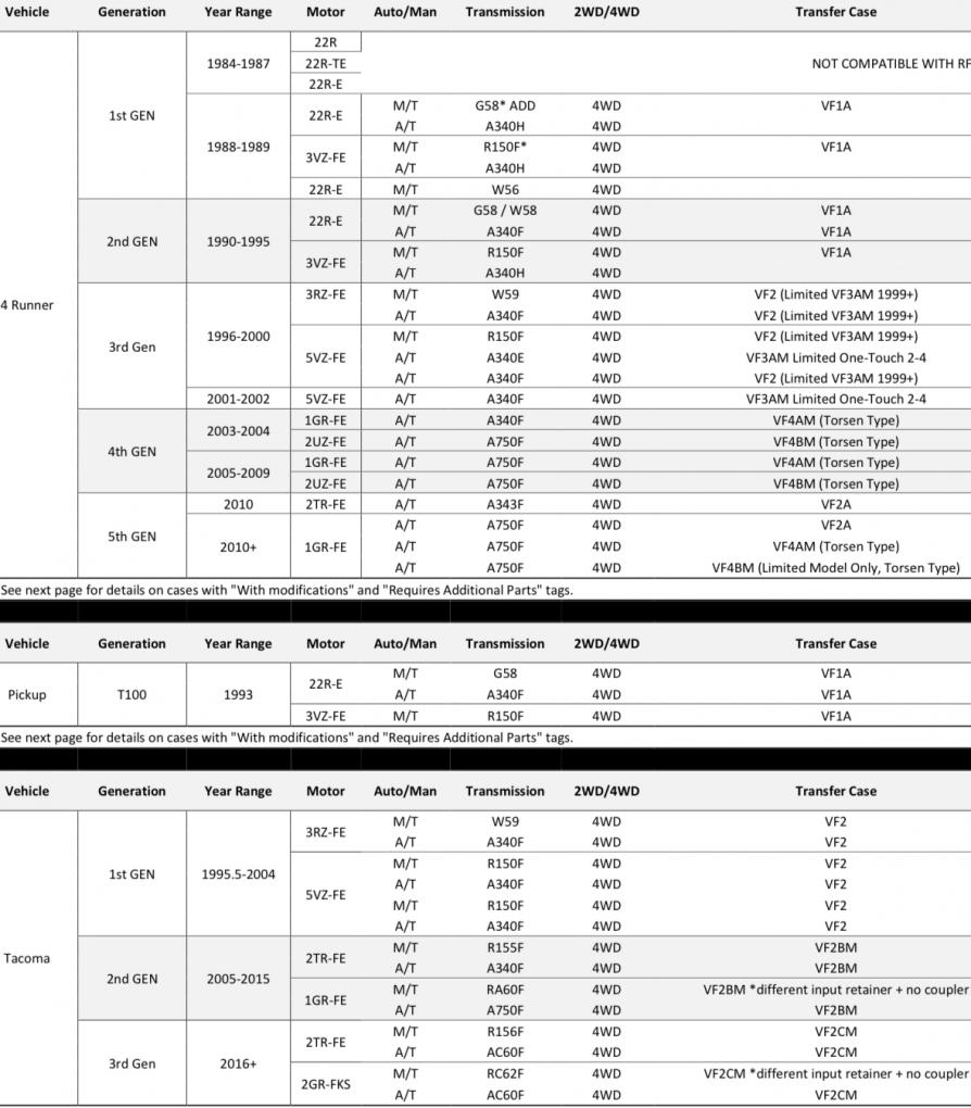

Necro bump but just want to correct this for future readers
The VF1a NEVER came stock behind a Tacoma, 4 or 6 cyl.
