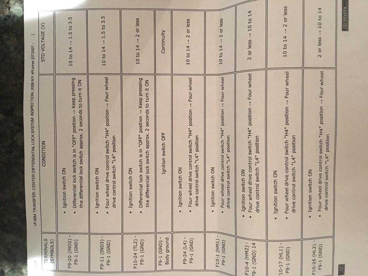

My transfer case wouldn't go into 4lo when I first bought the truck. It would go into 4hi and the center diff lock worked, but I tried everything with no luck to get the truck into 4lo. Tried every possible combo of shifting- 2hi straight to 4lo, 2hi->4hi->4lo, etc and tried rolling forward, reverse, slow, fast... nothing worked.
Took it back to the Toyota dealer and these are the steps the did to fix it for free. Basically they were going through the inspection steps and 4lo started working. Maybe it was a coincidence, or maybe unplugging and plugging wiring harnesses did something. Either way it saved me lots of time and money.
Hope this helps, not my fault if your 4Runner blows up.

...the tech left this guide and 2 pieces of paper clip in the 4Runner . I don't think this took any special tools other than a multi meter and short pieces of metal/wire to jump connections.
BlackWorksInc posted a Toyota training guide with very similar info. However, the stuff you have is more of a checklist. I think it's more useful as a "step by step" for those of us that don't tear into the 4wd system every day.
