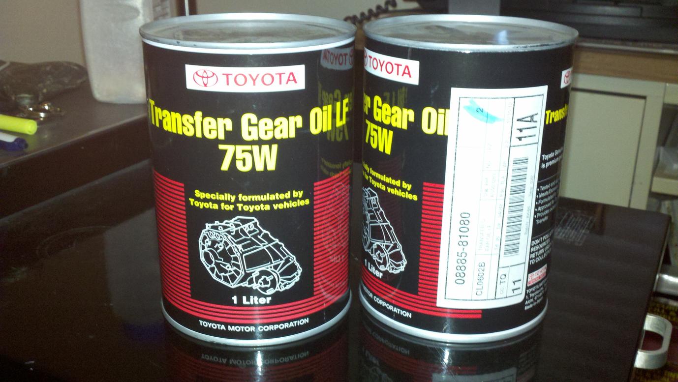

OK I went ahead and ordered this product over the weekend, and here it is Thursday and it arrived already. I have to thank Mick1 again for the link and also say that this vendor is good.
I paid $133.35 with tax and shipping for two one liter cans. Kind of pricey but at least I now know that I have the correct lubricant for the transfer case.
Odd that it comes in old fashion metal oil cans like we used to get motor oil in back in the day. I'll have to see if I still have a spout laying around somewhere, or else just use a church key to open them. LOL

Chmura, I tryed to show it in the photo, it is 08885-81080. The link in the previous post by Mick1 has the part number and the vendor that I ordered it from.
