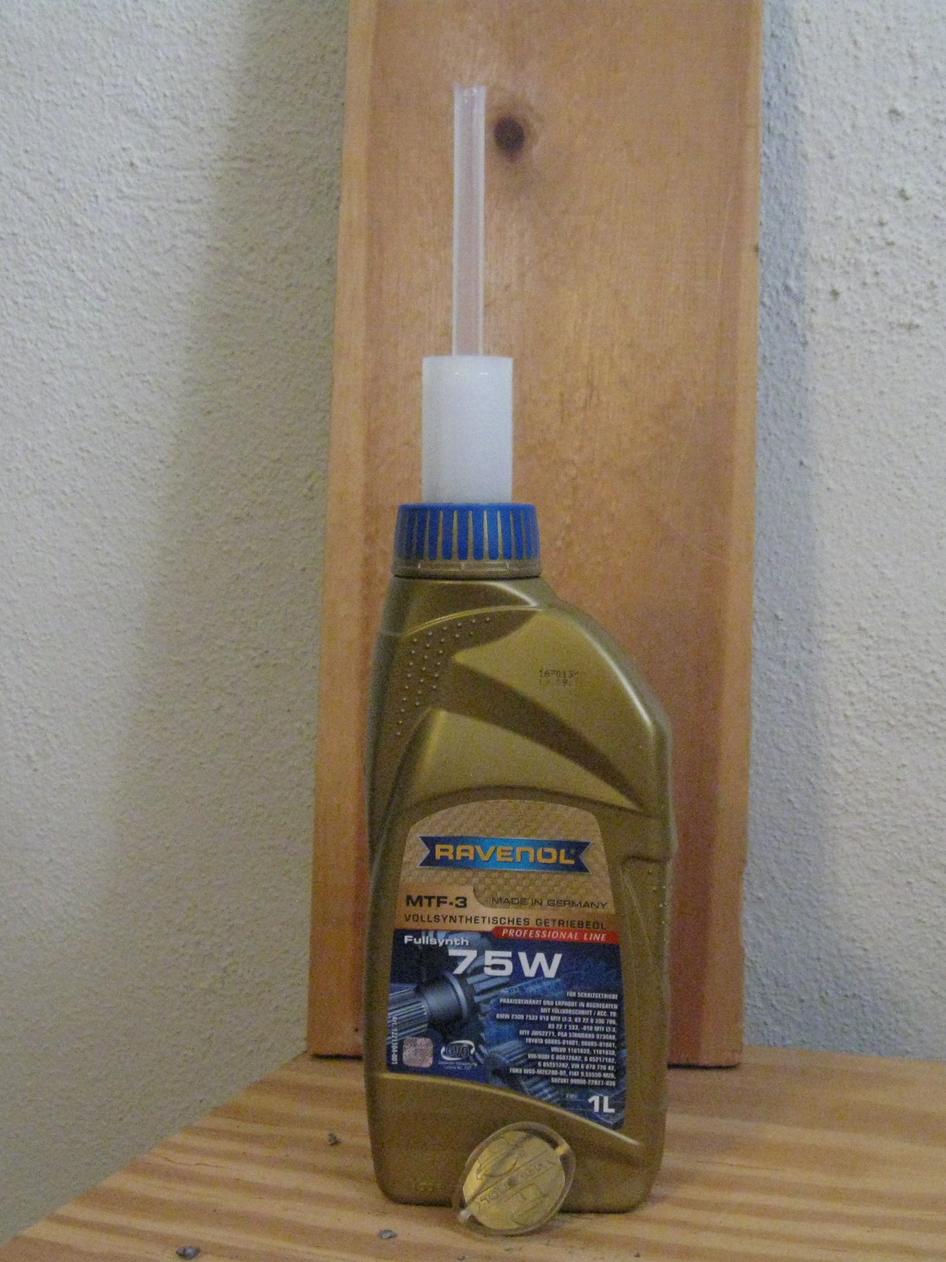

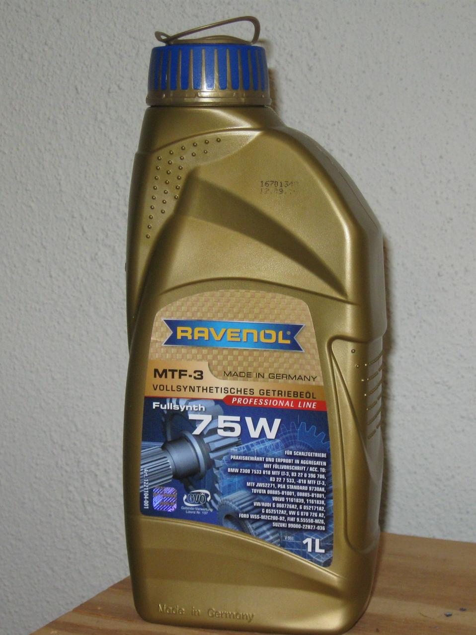

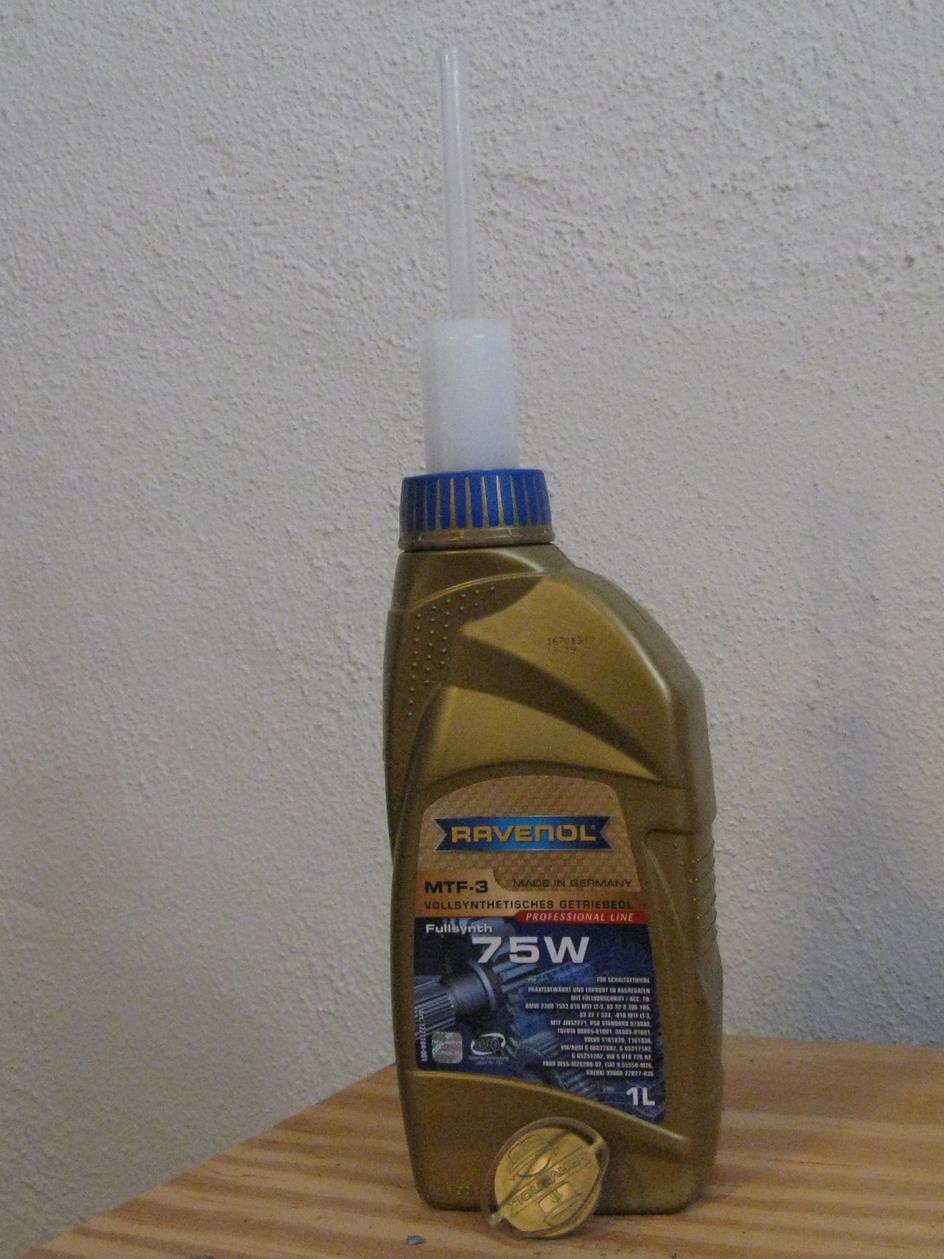

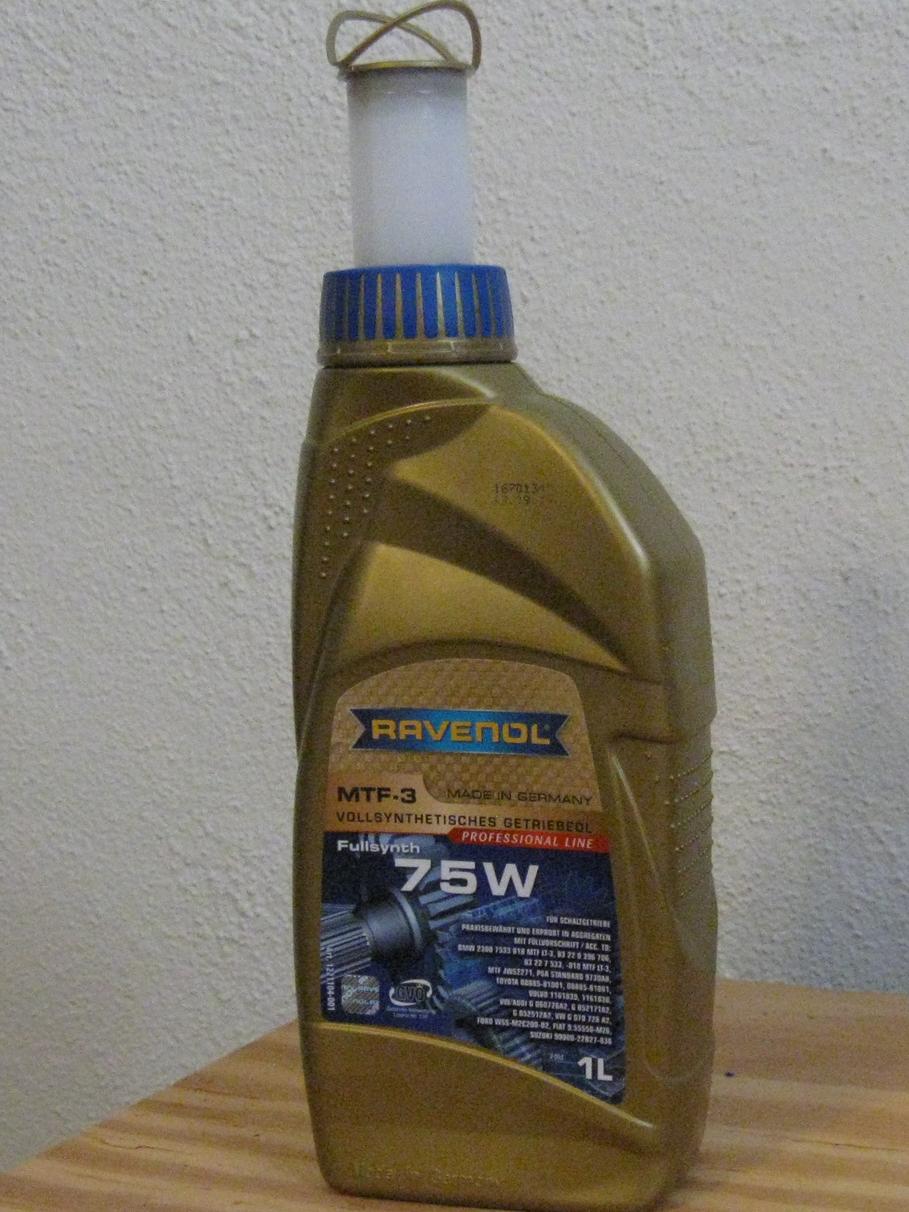

I finally got around to putting Ravenol in my transfer case today and the 1 Liter container was perfect amount. I'm adding a few pics to show the clever idea they used with the bottle, unfortunately I had my own refill ideas by transferring the oil to my own container. I believe my transfer was unnecessary and the built in spout on the Ravenol bottle would have worked given the space available above the transfer case inlet.
Pull up circular handles and yank upward to expose large white cylinder, next unscrew gold circular handles and yank upward second time to bring up tube.
Have a beer.
