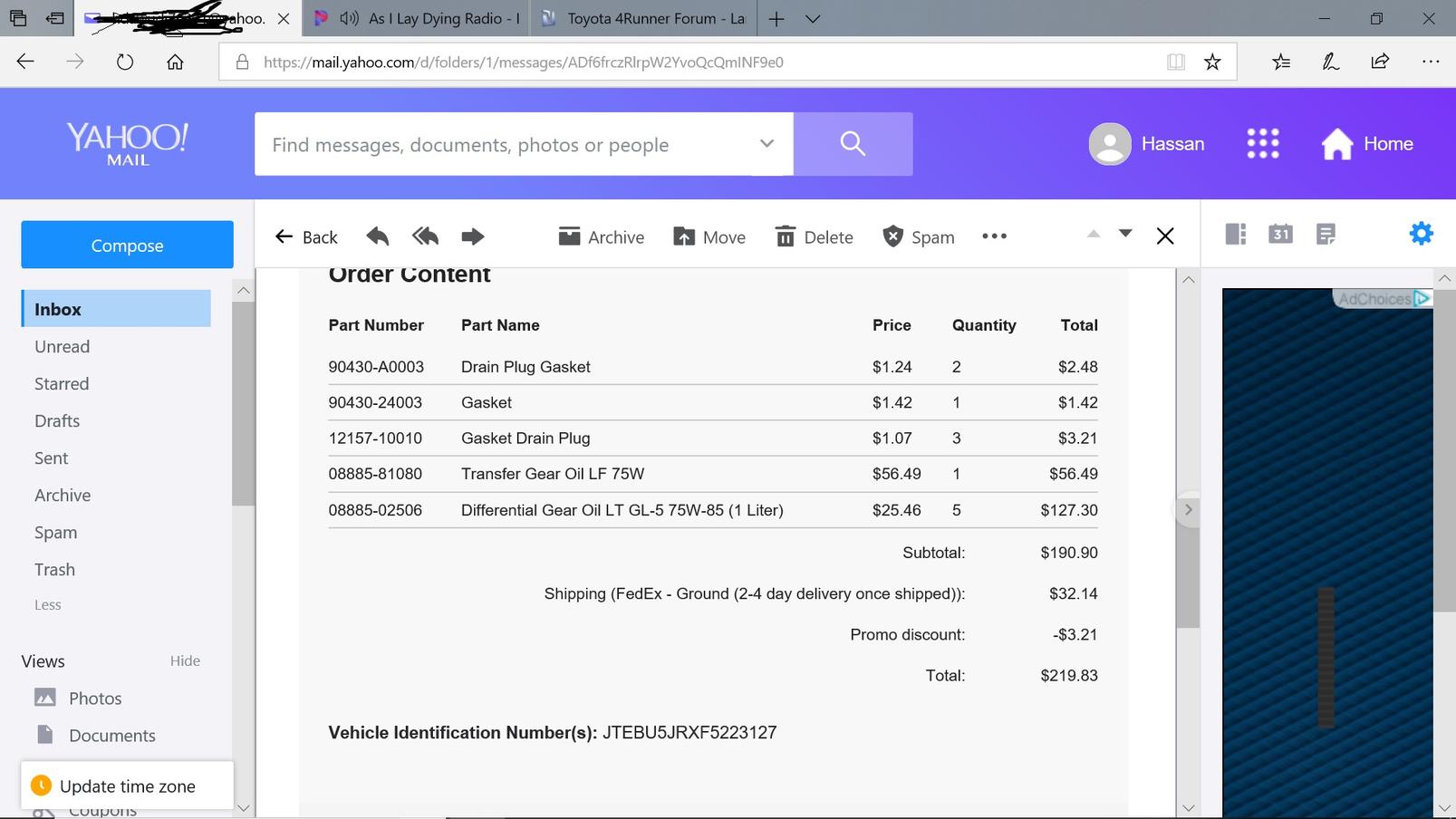

Chalk me up as another victim of 2 dealerships having no idea of, nor carrying the spec'd TC oil. The one place stated they use non-LS 75w-90 gear oil. Guess I'll order the Synchromax from Royal Purple and try that.

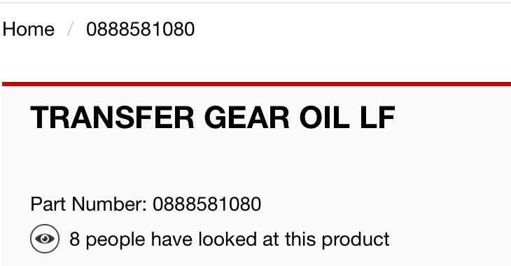

I made the mistake of buying Genuine Toyota Differential Fluid, 75-90W, when I thought I was getting 75W transfer case oil. It came in a metal can like the one shown in a post above but it was the wrong formula oil. I had the job done before I realized my mistake. I've been running it for about 1000 miles so far with no noticeable change.
I'll be looking for the right stuff next time I change the transfer case oil.
