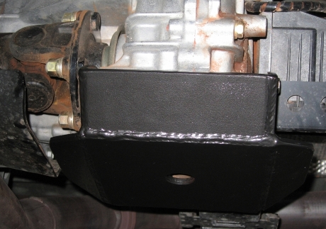

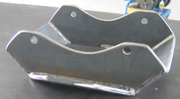

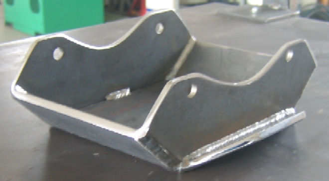

This has been built for me by Stubbs Welding and is updated from the original version.
http://www.stubbswelding.com/ready_welders1.htm
Since the trans case oil is not changed often there is no clearance hole for the drain plug. The skid plate must be removed. It is 1/4" steel on the horizontal plates and 3/16" on the vertical.
one more. Once I have received it I'll add pictures of it installed.

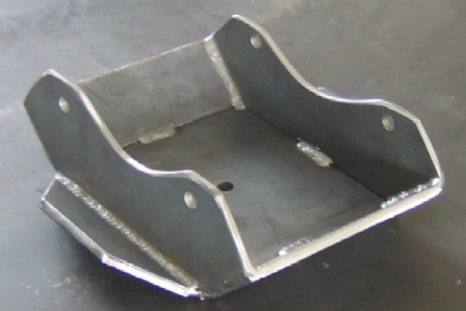

Fit Check
OK, so which one would you want on your transfer case??

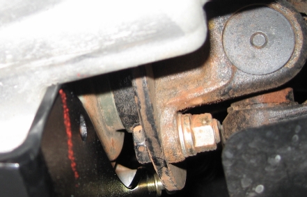

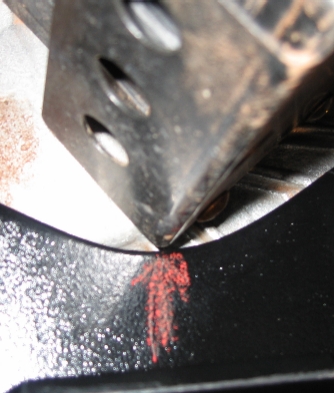

As part of the project for the first item I did the fit check and found two small areas that I wanted to improve. I've emailed pictures and shipped the marked up skid plate. He is predicting a fast turn around but I am willing to wait
This picture shows where the transfer case actuator comes a teensy bit too close to the skid plate

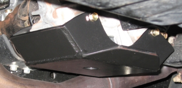

Fit Check
Here is the other spot, the right front mounting point. It needs a little more radius at the marked spot to avoid part of the the T-Case housing

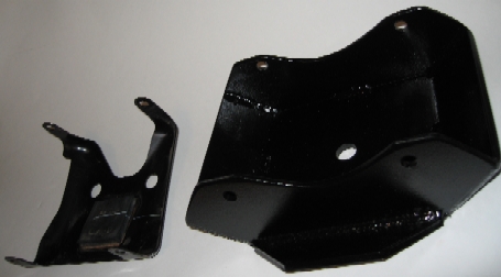

Updates
I talked to Richard today. He had a 4th Gen come in for a slider install on Saturday, someone from LA actually. Anyhow, he took the opportunity to try things out and found some differences between the housings for full and part-time 4WD cases and adjusted his templates. If you order be sure to specify your drivetrain.
Today Richard was painting and shipping the first two new versions, one for Joel and one for Moi.
Pix will be posted as soon as possible
