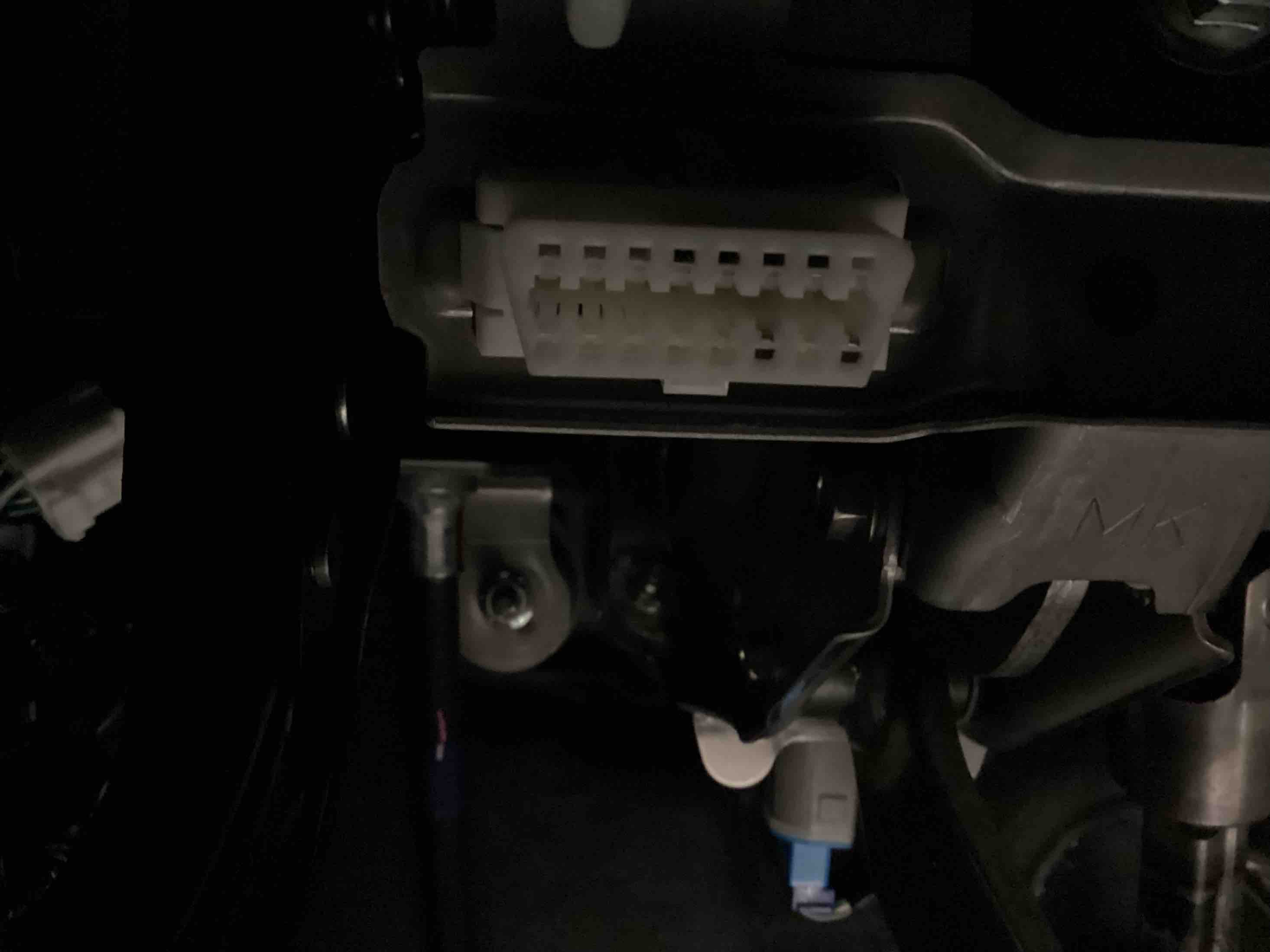

I have a 2023 SR5. I think Toyota took away the ability to get into temp check mode using the 4 and 13 pins on the OBD connector. There are only 6 wires going into mine on pins 4, 5, 6, 7, 14 and 16.
Can anyone verify this, or hopefully we use different pins now?
Thanks
Maybe but wouldn't use it but I use Torque app is easier.
Have you used it on a 2023? I have a Foseal ELM adapter and I tried it with CarScanner App but it didn’t show ATF temps.
Edit: I’ve been trying different things and I’m getting a pan reading using the Car Scanner App, paired with the Foseal WiFi adapter.
