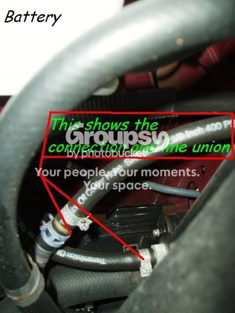

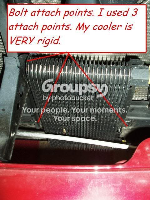

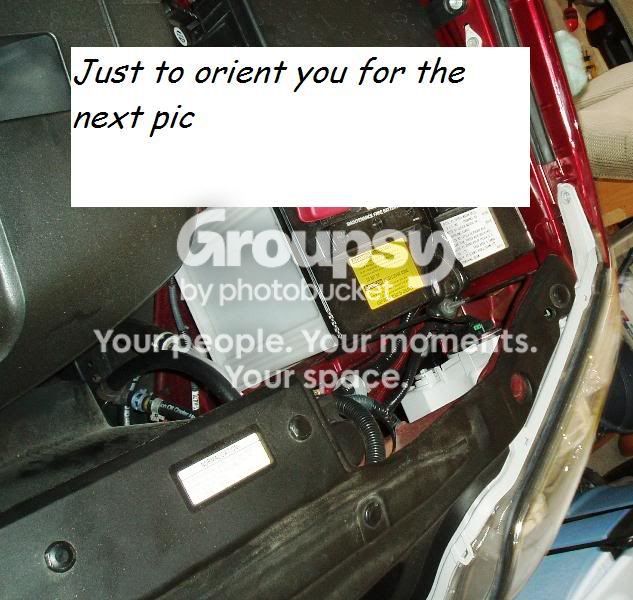

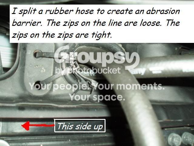

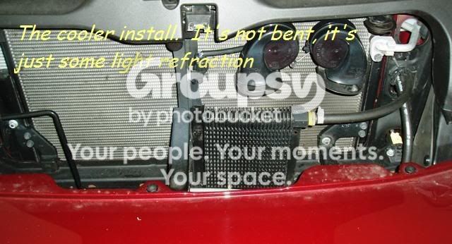

Bored. Thought I'd add a few pics of my install. I took inspiration from LV4R, thank-you.
:cheers:
1-1.jpg~original
2attach.jpg~original
3route-1.jpg~original
4lineorientation.jpg~original
5line.jpg~original
boostedprozac said:
how much hosing was used? I'm planning to pick one up from summit racing. They have many many brands for great prices!
Make sure the cooler you get is setup for 3/8" line size. Many have 5/16" fittings which will restrict flow. I chose an engine oil cooler and screwed in my own fittings.
How much line? I forget... I purchased by the foot fom a local parts store. It's cheap. Get 8 feet and you'll be fine, 5-6 is probably enough but why come up short. It's 3/8" ID hose. Get genuine transmission cooler line (not fuel line) and I highly recommend fuel injection style hose clamps. NAPA stores usually carry both.
Look at my pics to see the clamp type.
:cheers:
what size was your cooler? I'm about to order the B&M SuperCooler 11'' x 5-3/4'' x 3/4'' . I hope thats the right size and fitting.
I got it...installed it......and it's fine! Hardest part was figuring how and where you want to mount it! I also did not add any oil...or lost any oil. EASY! Should be the first mod!
They ALL have lines going to the side of the radiator for cooling......but ONLY the V8 had an external cooler after the radiator. The V6 didn't have the external cooler.
MikesToy said:
WTF? :confused: Mine already has one. I thought ALL 4th Gens already had intercoolers installed.
V8s have the additional auxilary cooler installed in front of the radiator. V6s do not. Both have a cooler inside the radiator. So there are two on the V8, one on the V6.
I bought the one that CJ3Flyr linked to and I believe boostedprozac installed.
I was just out there for a while trying to figure out how to mount it. I ended up trying to do what Chris did with 3 mount points but mine didn't line up well with the holes provided.
However, in doing so, I tried to put one of the longer bolts that came with the B&M cooler back into the bottom left mounting hole that Chris used and ended up ripping the bolt head off, pretty easily I might add.
So, I need to figure out how to get that bolt out of there now but when I do, any advice on how to install the B&M? I guess I'm looking more for boostedprozac's final setup since I have that exact same one but all advice is appreciated!
I'm going to have to cool off on mods for a little after this one, my girlfriend is getting annoyed with how much time and money I'm spending on my t4r recently.
So, I need to figure out how to get that bolt out of there now but when I do, any advice on how to install the B&M? I guess I'm looking more for boostedprozac's final setup since I have that exact same one but all advice is appreciated.

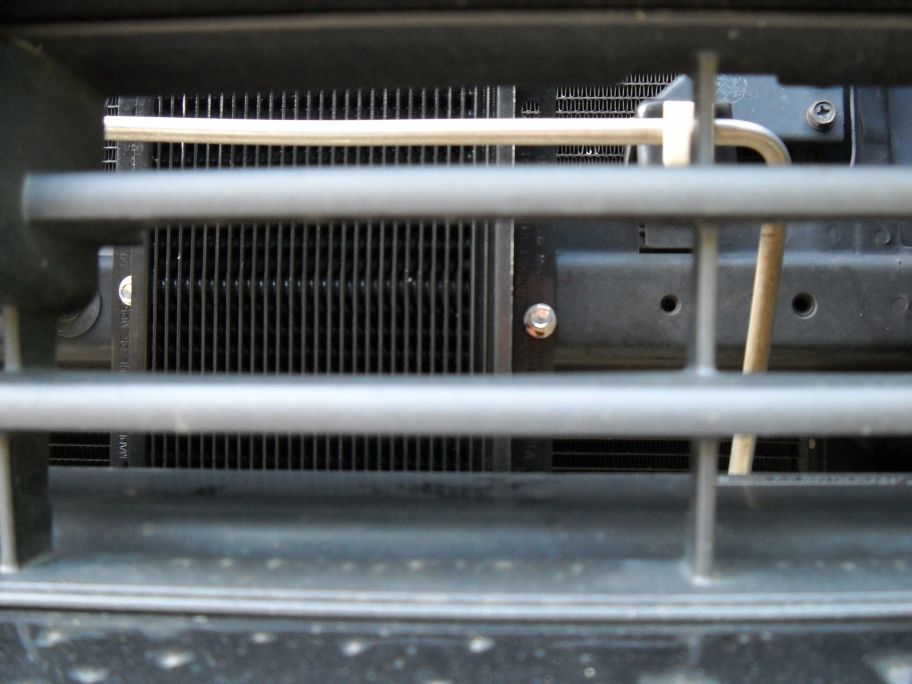

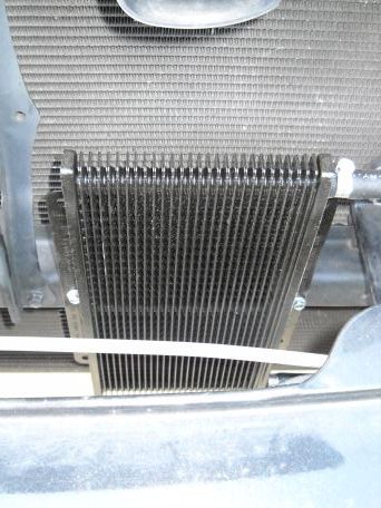

I bought and installed the B&M Cooler that CJ3Flyr recommended as well. I installed mine in a similar place to where he installed his, but i just used some self-tapping metal screws and lock-washers and drilled through the frame in front of the radiator beneath the horn. I've had it mounted there for a couple of months now and nothing has come loose and I've had no issues.
Here are a couple of pics.
Hope this helps.

So from what I have read you guys came off the bottom of the factory rad/trans cooler and went into the secondary cooler then back to trans line. Correct. So the top line going into the rad is where the hottest fluid would befor a trans temp sensor. Please correct me if I am wrong.
Thanks,
