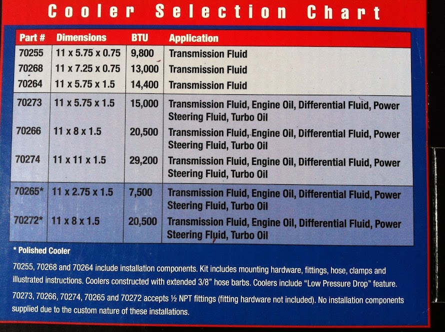

2) there was a handy little chart on the box of the B&M cooler that shows the thermal capacity. had i seen this, i might have gone for a bigger cooler. i got the 70255. on the other hand, it blocks less of my AC condenser.

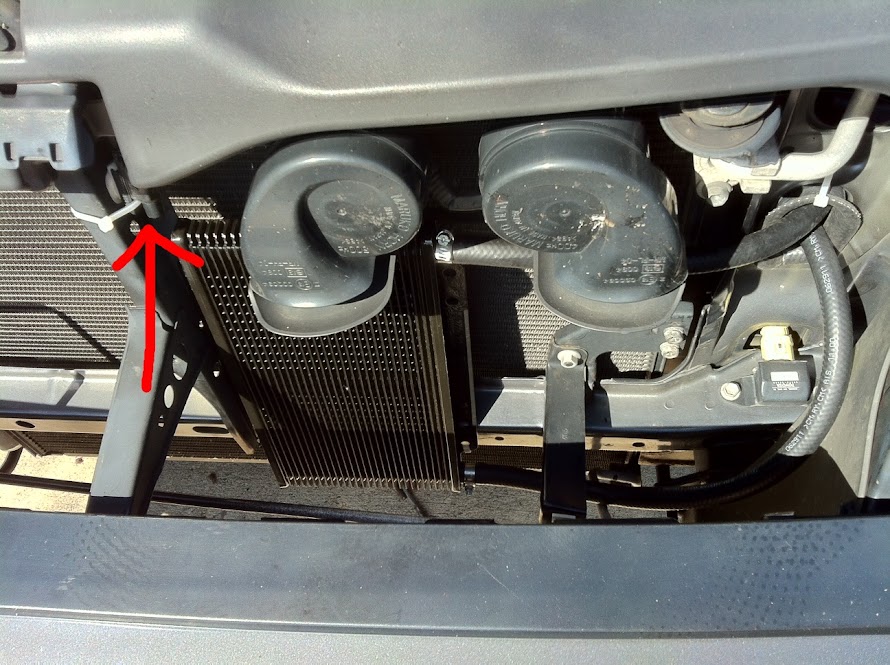

Just installed my Hayden 677; bought it at PepBoys for about $55-60. Used 3/8 ID coolant hose (bought 8' ; rest is spare hose) and used the plastic zip-tie connectors to mount the cooler to the condenser/radiator. The Hayden kit came with 5/16 hose, although the I/O connectors were 3/8.
I routed the lines through the same radiator frame (hole), used some cut hose to line the metal hole and protect the new lines to/from the cooler. Lost at most about a teaspoon of tranny fluid. Didn't refill or top off with any WS fluid.

I've got my B&M 70264 mounted up and am ready to make the connections. Before I pull hoses I wanted to verify that I have the correct understanding of which trans fluid hose I will be tapping. I know that I will be using the fluid line coming OUT of the radiator trans cooler and from the pictures and descriptions (thanks CJ3Flyr and others) I think this means I will be pulling the lower of the two hoses that currently connect to the radiator, correct?

Managed to get everything hooked up last night and verified via both the FSM (a little hard to confirm) and with my infrared thermometer that things are hooked up correctly and that it is indeed the lower of the two connections to the radiator that you pull and place the cooler in-line with.
I didn't splice cooler lines and instead just used fresh trans fluid line to make the run from the radiator to the right side of the cooler and from the left side of the cooler all of the way to the hard line on the bottom cross member. The infrared thermometer made it easy to see which direction things are flowing and that there's a temperature drop in the trans fluid across the cooler even when the fluid is only 110 degrees (about 10 degree drop during my observation).
