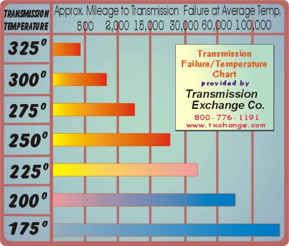

and to the OP, you will want a tranny cooler i have a document(ill try and get it posted here) that states(yeah i know it could be from fox news) temps over 200 can start to drastically shorten the life expectancy of your trans. by simply adding a cooler your not only will cool your temps but increase capacity withc is imo just as big of a benefit as cooler temps.
here is a link to what i came up with with a quick google search, now take into account that this guys is speaking of constant temps which for the most part is unrealistic but it gives you an idea of the (potential) damage that can occur with higher temps fluid temp versus transmission life expectancy - Bob Is The Oil Guy and here is a way over blown but yeah you can still get an idea of whats being said trans temp chart.jpg

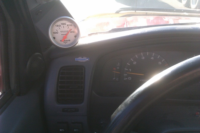

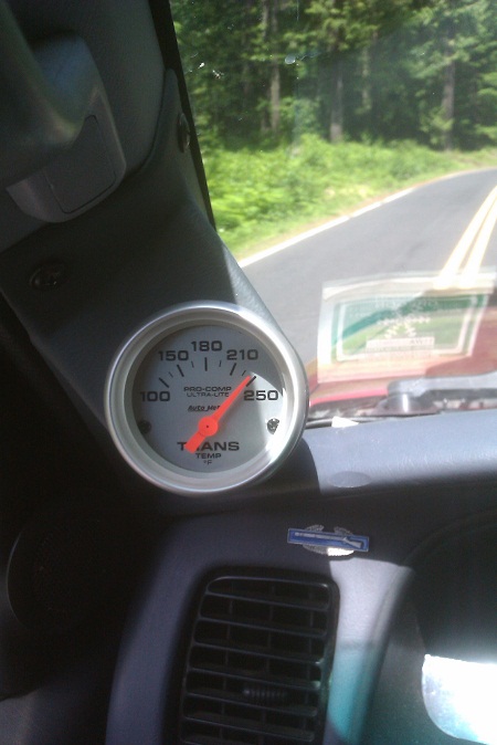

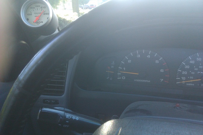

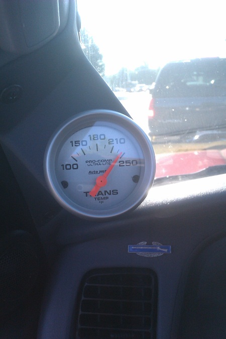

i have a trans temp gauge as well as two coolers, a B&M 70624 and a perma cool with a 10" electric fan on a thermo switch. i still see temps over 200 with mine, but driving on the freeway they stay around 150 or so but in town they can climb to 200 and if im climbing a hill or pulling a load at lower speeds say below 35mph then it will really climb. but i also have stock gears(4.10:1) and E rated 285s on 17s with full skids(motor, belly, and tank) along with sliders so ive got a lot of extra weight(thus the second cooler). my temp gauge is before my coolers so im reading the hottest temps. i have an auto meter gauge that ranges from 100-250 and i have pegged my gauge several times and once it gets that hot it takes quite some time for the temps to come back down, so i was looking at those temps for over 30min sometimes. here are some pics of my gauge and coolers ect.
this one is just from climbing a long grade at the base of mt st helens it was a two lane mt road with a lot of switch backs so i could only really ever get up to maybe 45mph and that was having to push/work it
this one is just sitting in traffic in portland or, it was only in the mid 80s that day but i was in rush hour and it was stop and go for over an hour
this just shows my engine temps as well...
this was another day when i was out wheeling, i actually had the idiot light come one in the dash for my trans temp, i pegged the gauge so i have no idea how hot i actually was(this was before the perma cool w/fan install)

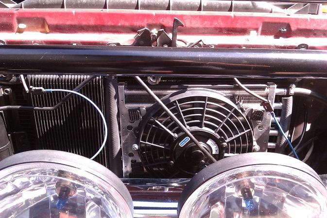

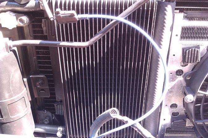

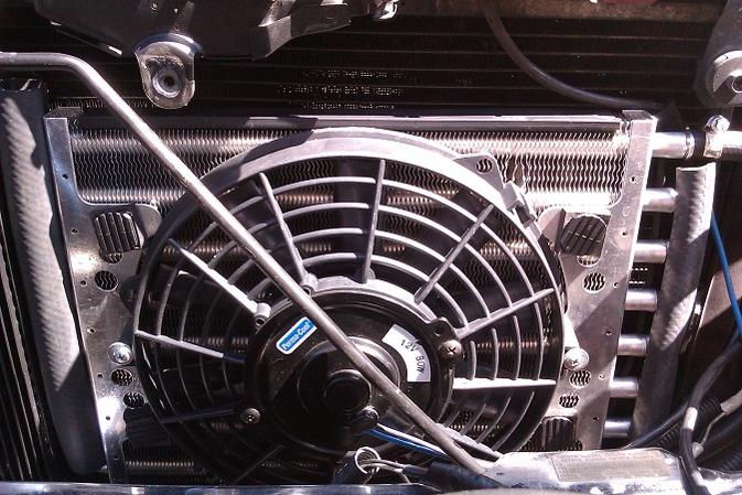

this is a pic of my set up with the dual coolers
this is my perma cool cooler with the 10" electric fan
this is my B&M 70624 cooler which i initially installed only to find out it was not enough and could not keep up

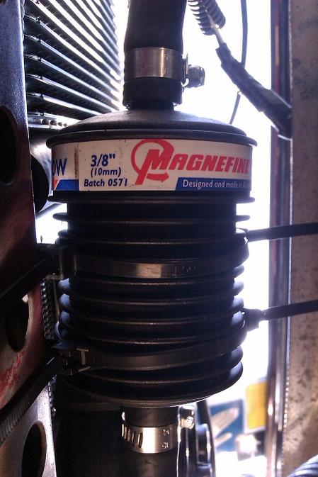

this is my secondary inline filter that i also installed cheap only about $8 if i remember right but well worth the peace of mind imo
i think all together im in it
$65 or so for the B&M
$50 for the auto meter gauge
$110 for the perma cool with fan
$18 for the thermo switch for the fan
$8 for the inline filter
$16-20 for the 3/8s trans line
$20 for the pillar mount for the gauge
sure its kinda spendy but it beats the $3000 for a new tranny or a tranny overhaul
