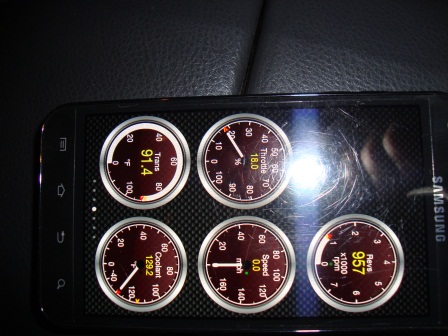

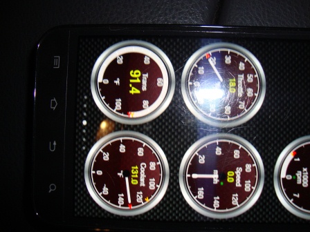

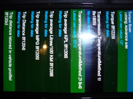

Well, not sure what to tell you. The proof is in the pudding.. so here are pictures.
Edit: I have a 2005 v8 4runner.
Works perfectly for me. As you can see, it is not confusing Coolant. I am getting 2 different, and independent readings.
If you are wondering why my trans temp is so low, I walked out and just turned it on to do this. I didn't even put it in gear. Had my truck at idle while I took photos with my camera.
Some notes: Things I did, that I am not sure matter. 1. I ran the PID scan. Not sure if that matters... but yes, as you can see; I am getting data from Trans temp, method 2. I selected units as Degrees. I guess the torque scan part still does C, but it converts it for me on the DASH part.

I did searches over a couple of months or more of transmission threads, and this is the first that I ever heard of the Torque app, and that it could pull trans fluid temp. I don't know why no one mentioned it before in the transmssion temp discussions. Perhaps few know about it. Anyway, I have a Galaxy Nexus. If this works with the Torgue app, I would have never purchased a Scan Gauge. Even so, for the costs involved, I am tempted to buy an OBD scanner and the paid Torque app anyway.

To help you guys out, I am wiping my android phone I use for this. It is an off contract, no longer cell service HTC EVO. Your standard android phone. Runs 2.2 I believe.
I am tinkering with it right now. I want to see if I had to install or do anything special to Torque to get access to the Trans data...

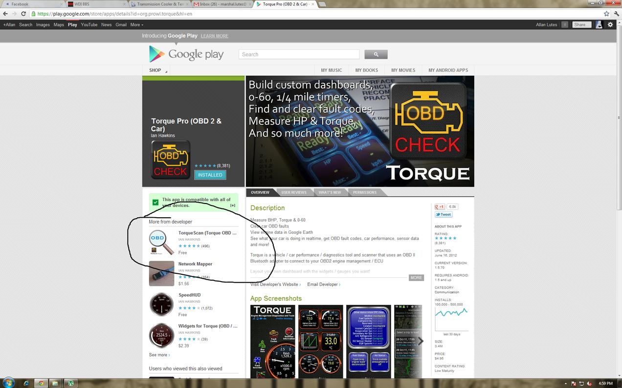

Make sure you get the torque scan add on app....
Edit: I just tested. You do not need to do a PID scan (which as I recall takes forever). All you need is: 1. Paid App 2. The Torquescan Add-on (found in google market/play as Torquescan).
3. Start App, set profile. 4. Go into torque scan, you should see Trans Temp Method 2, and it should show data. Mines does, auto. This is off a phone that was completely wiped, fresh install.

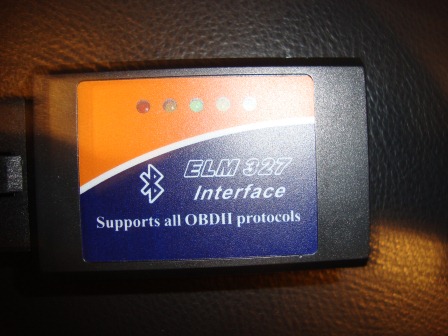

Who knows, the adapter I got (same as yours DC) could be defective. It did report I think ''1 fault and like 3 errors'' associated with the adapter unit. That could be my issue. But other sometimes it would say no faults. They only cost like $15 on Amazon, but I don't know if its worth trying...
Maybe I'll just roll with the SC2 when it arrives tomorrow... (If that even works!) Could be my runner not reporting the info for all I know. All other things I'm looking at report themselves perfectly. You can see the coolant from when I first started it below. Not sure why that's the only dial showing ''C'' rather than the ''F'' that I chose and the others show either... But either way, its getting no info in TorqueScan or the real time info.
I get no Faults when I use mine... and I think it is your adapter. When I bought mine I knew that there were several different companies and that they can have issues (cheap Chinese quality control)... I tried to buy a unit with the highest ratings.
This is the one I bought. At 18 bucks, it was worth the quality control issue. I suggest you return and try again.

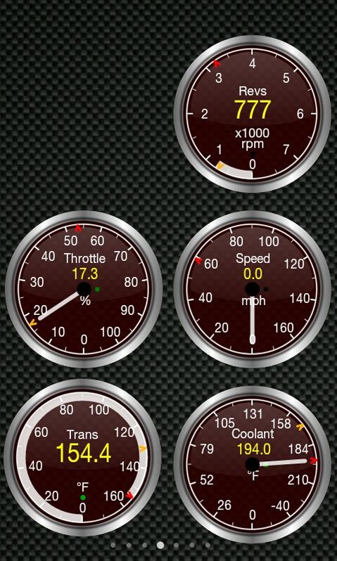

I didn't know the app could take a screenshot, but it does. Here is data while driving, as you can see, it is reporting trans temp in line with what you would expect.

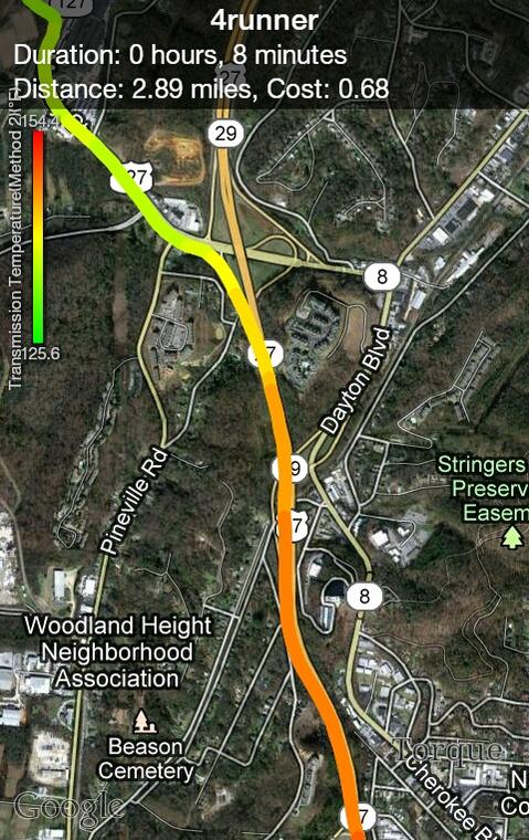

Finally, the awesome that it allows. I have it record about 9 things.. Coolant temp. Engine Load, Trans Temp, and a few more. It auto records every trip, using GPS. It then overlays that data on google maps, letting me know what is going one exactly where.
Here is a screen shot of it looking at Trans Temp. As you can see it peaked at 154 and hung out in the 140's for most of the short trip.
