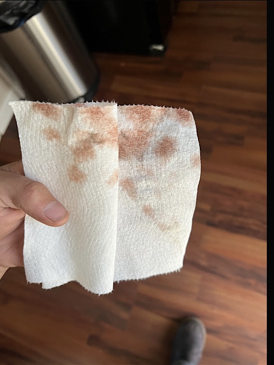

Alright, im reviving this old thread instead of starting a new one since it has a ton of good info. Think im gonna pull the trigger and do a simple drain and fill on my 04 (w/dipstick). Admittedly I got scared of all the horror stories of trans flush/drain and fills on high mileage vehicles so I never wanted to do it. As time has gone on Ive got more into DIYing and Ive been doing work on my 4R myself.
Anyways, Im currently at 216k and Ive never touched it. Bought it at 111k. Checked the fluid and its still very pink/red. Im under the assumption it was probably serviced before I bought it at some point if it’s still this color. I think Im still in the clear. Gonna start slow, and see how the first drain and fill goes!
Any tips or advice are always welcome!
Edit/Update: did the drain and fill. The truck is shifting so much better now. 1st to 2nd sometimes felt hard, well thats gone now. Silky smooth. Valvoline Maxlife ATF rocks! Drained just under 4qt and put 4 back in, shifted through all the gears a few times and then took it for a drive to warm everything up. Level on the stick was right on point when I got home. Gonna repeat in another 15k.
