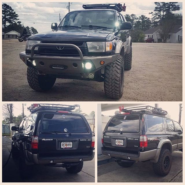

Here pics of the truck when I picked her up.
