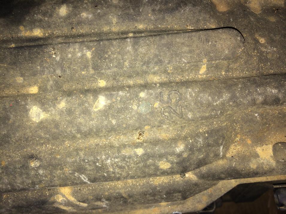

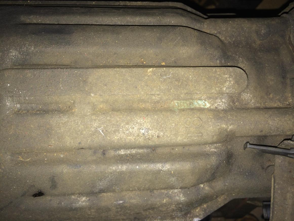

Well...I got my blown transmission/transfercase out and bought a used replacement. It came from a salvage yard and has the torque converter already installed. Should I just throw it in there? Any useful tips? I will be doing this job with the truck on the ground. I bought an attachment for my floor jack to turn it into a transmission jack. Also, the casting for my new trans has a marking on it that's different than my old one. I was wondering if you all knew what it meant. One is a 25 and the other is a 18.

....that sucks. I wish I could tell you, but I have no idea. What was different about the vehicle that it came out of? I'm not sure I'd worry about it if it's all the same. I could definitely be wrong though, so it would be nice if someone knows something about that number.
Idk what the number is. But what years are they. Whag did it come out of and what is it going into, because there are differences. Kick down cable versus wire. I think 3 different valve bodies and such.
It came from a salvage yard. They said it was from a 96 4r. My 4r is a 99. It looks like there was a sticker on the top of the salvage yard trans that was removed but you can still make out the lettering. It looks like it said 3d460. On the trans that I pulled out of the my 4r, there is a sticker in the same place with a model number of 35010-3D670. I called the dealer and they said that the model number for a trans for my car is 35010-3D550-87. I think the trans from the salvage yard is a 35000-3D460. I feel like it should work, I just do not have a way of being certain.

The numbers on the casting could be a mold number for tracking purposes. If Toyota is using multiple molds for those pans, then they likely have to mark them with a mold number to be able to track defects back to a specific mold.
A PN of some sort likely wouldn't be only 2 digits. 2 digits smacks of mold/cavity #.
