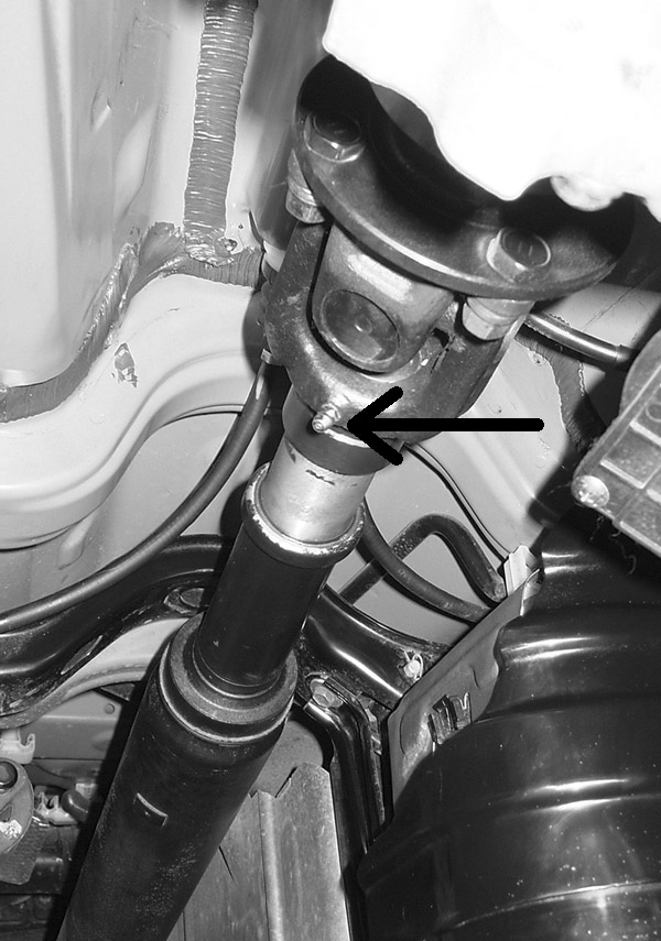

My '04 SR5 had a similar problem. Pumping grease into the zerk fitting at the driveline spline shaft made it go away. Give it a try...

Did you try pumping grease here?
mcbean7 said:
I'll try that next. Thanks Iowa4Runner.
No problem... I think I put in about 10-15 pumps when I did mine the first time. I didn't see any grease ooze out right away but a day later I could see a thin grease film had formed at the seal. I haven't heard the clunk since. :)

Get two Pistol Grip style grease guns with hoses. They are the easiest to use.
Iowa is showing the 1 Slide Yoke grease fitting. The 1 Shaft Spider fitting is in the middle of the joint next to it.
The Double-cardan is on the other end, 3 grease fittings.
Clean the fittings before greasing.
I try to listen and watch. The sound will change as it fills up. If you see grease, you pumped too much.

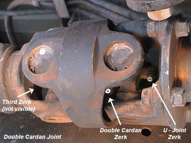

Do 4th gen 4Runners have Double-cardan joints? The diagrams in my Toyota repair manual refer to them as universal joints. I think a double-cardan joint looks like the attached picture, and I don't see any of these on my 4Runner.
