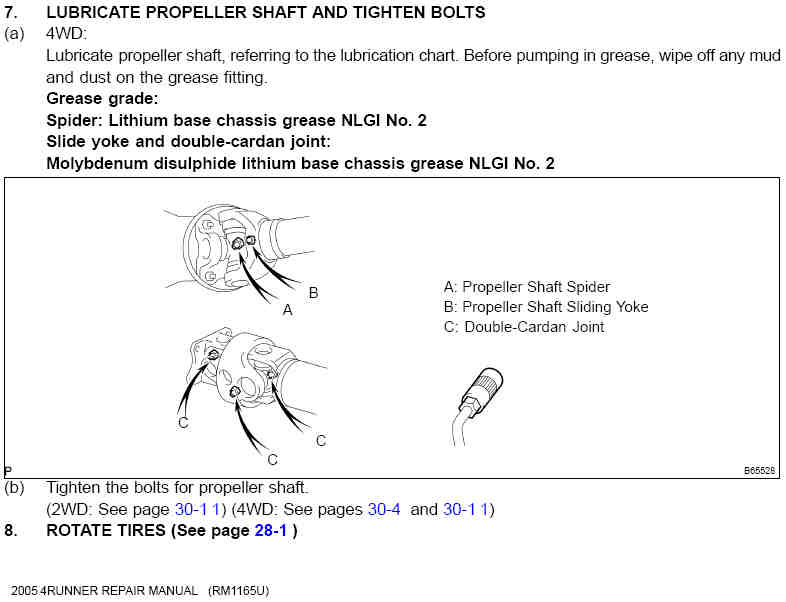

Iowa4Runner said:
Do 4th gen 4Runners have Double-cardan joints? The diagrams in my Toyota repair manual refer to them as universal joints. I think a double-cardan joint looks like the attached picture, and I don't see any of these on my 4Runner.
The 4Runner does not look like that picture. I don't know the differences. I wonder if the 05 manual is wrong?

That repair manual is still wrong!
There are no double-cardan joints in the 4th generation 4Runners (the 4WD ones, at least), but apparently they still haven't fixed the repair manuals. I thought it was just a problem with the '03 version of the repair manual set (expensive!) that I purchased. Apparently not.
This topic has been covered in the maintenance area of this board, so more info is available there.
As for grease, I couldn't find both of the two kinds they specified (and the local dealer was even more clueless than me) so I just used Mobil 1 synthetic grease for both.
I bought AMSOIL grease.
Series 2000 Synthetic Racing Grease (no Moly) and Synthetic Heavy-Duty Grease (Moly fortified).

Anyway, the repair manuals seem to have the u-joint / cardan joint issue corrected in the drive / propeller shaft section (chapter 30) of the repair manual. But, just like the '03 and '05 manuals, the Maintenance section (chapter 99) in the '04 manuals still has it wrong.
